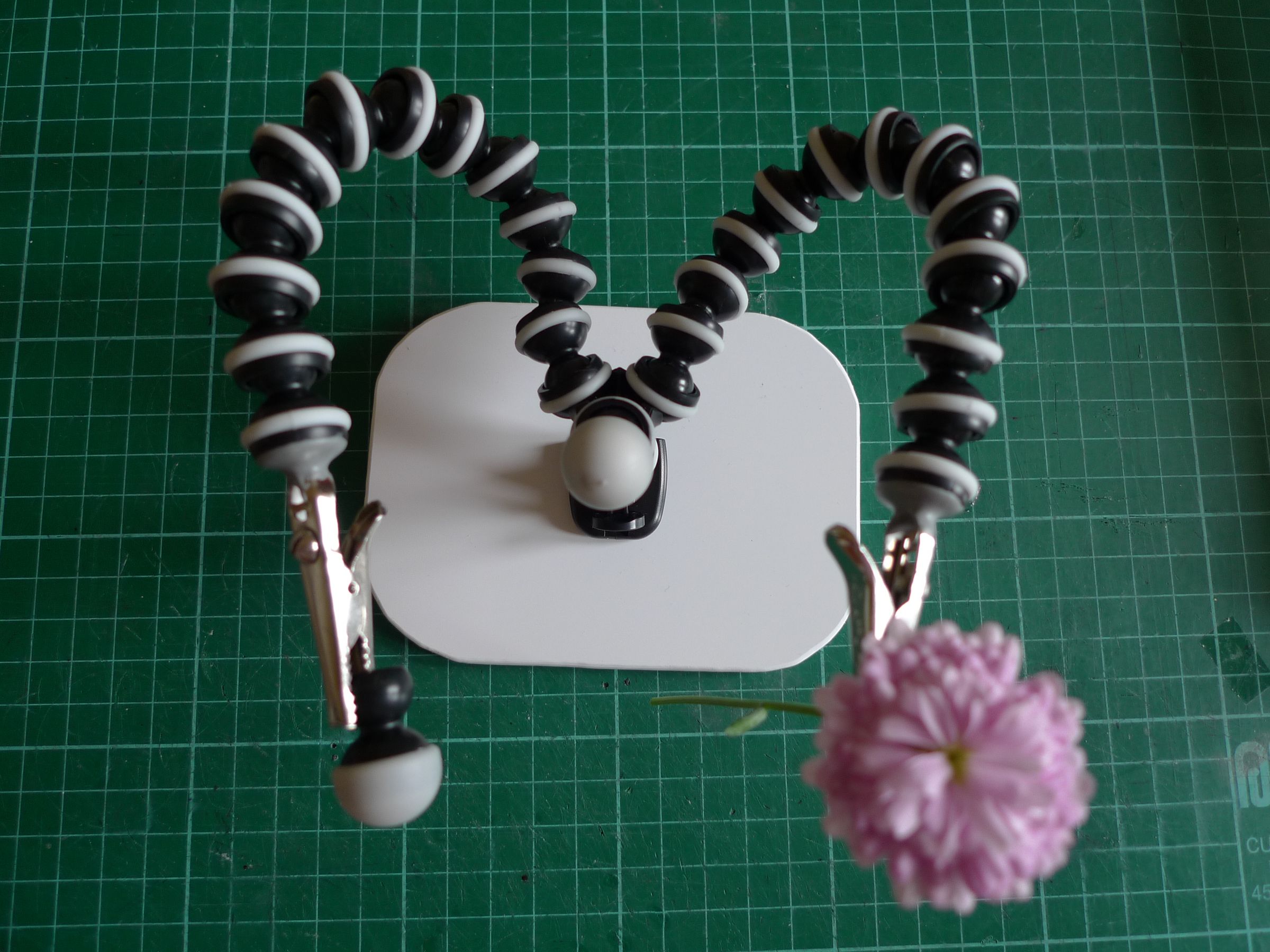

Step 1: Another Idea: Camera Mount for a Mountain Bike
The common screw thread for compact film/digital camera is:
1/4" diameter coarse thread - 20 UNC, or in metric 6.35mm, if in doubt bring your camera to the hardware store!
A trick when using this plastic is not to let two pieces stick together before it is cooled to room temperature, applying a thin coat of vaseline prevents sticking, it is useful when making a negative mould or imprint of an object.
It is also easier to work the plastic with a heat gun, where you can apply gradual and selective heating to specific area, a hair dryer isn't hot enough, not a solution.

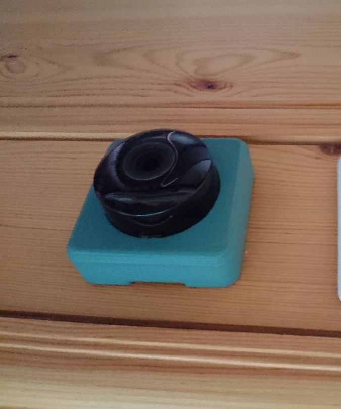

Step 3: Another Idea: Actuator Mount for a Kite Camera

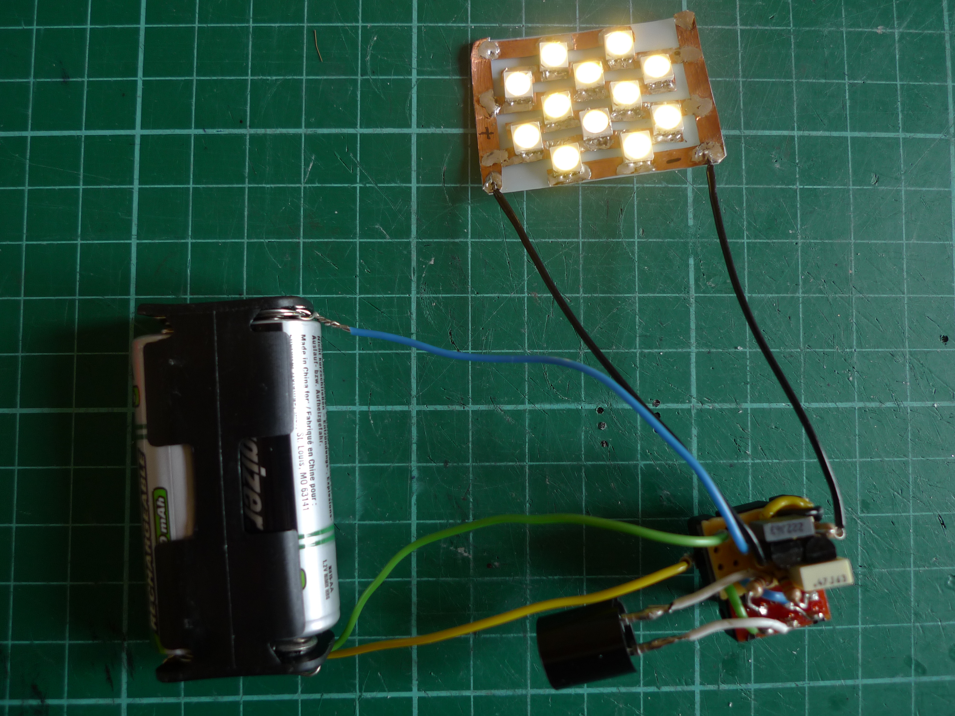

And for convenience, how about a battery spacer made from two screws?
