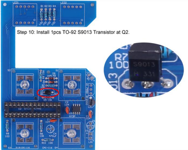

Step 10: TO-92 S9013 Transistor
Install 1pcs TO-92 S9013 Transistor at Q2.

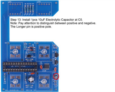

Step 13: 10uF Electrolytic Capacitor
Install 1pcs 10uF Electrolytic Capacitor at C5.
Note: Pay attention to distinguish between positive and negative. The Longer pin is positive pole.

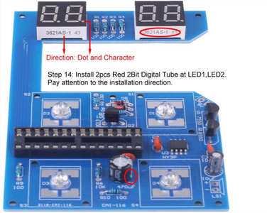

Step 14: Red 2Bit Digital Tube
Install 2pcs Red 2Bit Digital Tube at LED1,LED2.
Pay attention to installation direction.

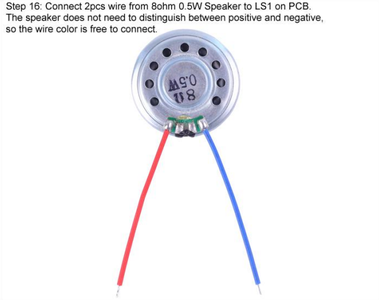

Step 16: Wire From 8ohm 0.5W Speaker to LS1
Connect 2pcs wire from 8ohm 0.5W Speaker to LS1 on PCB. The speaker does not need to distinguish between positive and negative, so the wire color is free to connect.

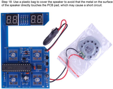

Step 18: Plastic Bag
Use a plastic bag to cover the speaker to avoid that the metal on the surface of the speaker directly touches the PCB pad, which may cause a short circuit.

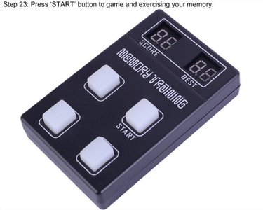

Step 23: START
Press ‘START’ button to game and exercising your memory.
