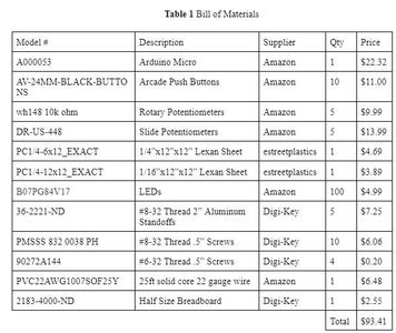

The following items are used in this instructable:
Electronics:
- Arcade Push Buttons [AV-24MM-Black-Buttons] [5]
- Rotary Potentiometers [WH148 10kohm] [6]
- Slide Potentiometers [DR-US-448] [7]
- LEDs [B07PG84V17] [8]
- 25ft solid core 22 gauge wire [PVC22AWG1007SOF25Y] [9]
- Half Size Breadboard [2183-4000-ND] [10]
Frame construction materials:
- 1/4”x6”x12” Lexan Sheet [PC1/4-6x12_EXACT] [11]
- 1/16”x12”x12” Lexan Sheet [PC1/4-12x12_EXACT] [12]
- #8-32 Thread 2” Aluminum Standoffs [36-2221-ND] [13]
- #8-32 Thread .625” Screws [276-4993] [14]
- #6-32 Thread .5” Screws [90272A144] [15]
A bill of materials is shown above. These were some of the cheapest options found, however if you find other components that you would like to add or use feel free! The only semi-permanent option here is the Arduino Micro. The MIDI controller requires native USB. Therefore, you must be careful when choosing your microcontroller as some do not have native USB. At the end of the instructable there are other microcontroller options that support native USB, and they should work wonderfully with this project.

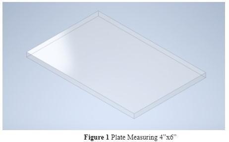

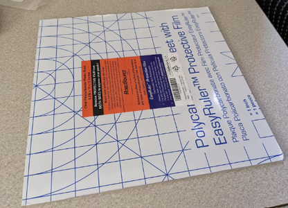

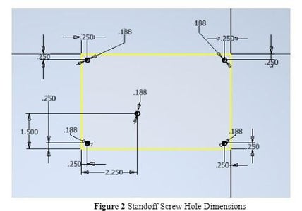

Step 2: Cutting the Frame
he frame consists of two pieces of rigid a material of your choosing. We recommend polycarbonate. The two plates are held together with several 2" standoffs. The following steps will show you the step by step on how to create the frame:
- Cut out two plates measuring 4” x 6”.
- Ensure they are the same size, and trim as necessary.
- Mark the hole locations for the standoffs according to the CAD drawing.
- Drill the holes for the standoffs in each plate so that they line up with eachother.
We used 8-32x.625 screws [15]. The drill bit that we advise using is a 3/16 inch bit. This is a clearance hole and will allow the screws to go in easily.

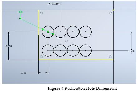

Step 3: Drilling Pushbutton Holes
Steps to drill the mounting holes for the arcade push buttons:
- Choose one of the two frame pieces to be the face plate.
- Trace the locations of the button holes. A quarter is approximately the correct size for this.
- Enusure that the buttons fit will onto the frame piece.
- Drill the holes with one of the following methods
- 15/16 inch or 24mm hole saw/drill bit
- Drilling a pilot hole, then increase the diameter with a dremel using a sanding bit.
- Drill a pilot hole and use a router
- Melt around the hole with a soldering iron
- Sand down any extra material around the hole to ensure the buttons sit flush
When in doubt, drill the holes small, then increase the diameter as needed. Make sure each button has a snug fit.

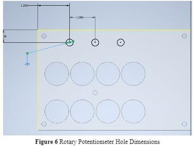

Step 4: Drilling Rotary Potentiometer Holes
Steps to drill the mounting holes for the rotary potentiometers:
- Mark the location for the the potentiometers on the face plate
- Use a 9/32 drill bit to drill the holes for best fit
- Ensure that the threads of the potentiometer stick all the way through the front plate so that the hex nut can engage the threads.

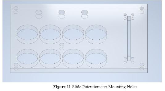

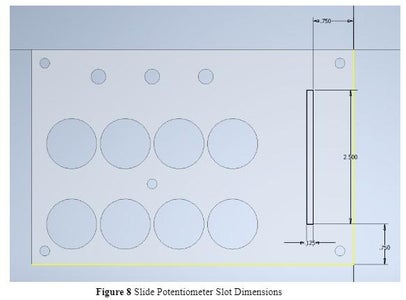

Step 5: Cutting Slide Potentiometer Slot
Steps to cut out the slide potentiometer slot:
- Mark where the slot should be located.
- The slides needs to be cut to a 2.5” length to allow for full operation [11].
- The width of the slot also has to be wide enough to allow the slide to move freely [11].
- Use a 9/32 drill bit or similar to drill a series of holes along the length of the slot and then use a file or sandpaper to smooth the edges.

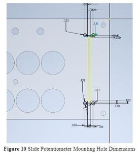

Step 6: Drilling Slide Potentiometer Mounting Screws
Steps to cut the mouting slot for the slide potentiometer:
- Mark where the mouting holes should be located.
- Drill the mounting holes with a #28 bit or larger.
- The screws used in the slide are 6-32 screws, so it will need a hole big enough for those screws at 0.131” [16].

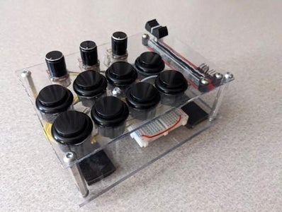

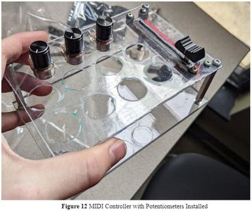

Step 7: Mounting Components
Steps for mouting the slide potentiometers the controller:
- Mount the slide potentiometer using a #6-32 screw on each corner [11].
- Tighten just enough for a snug fit, but not enough to bend or break the potentiometer.
- The screws should thread into the potentiometer holes directly.
Steps for mounting the rotational potentiometers
- One by one insert the potentiometers into the mounting holes.
- Tighten the accompanying nut onto the top of the stem.
- Ensure the nut is very tight so that it does not loosen while using the potentiometers.
- Spin each potentiometer as far counter-clockwise as possible.
- place the provided cap so that the notch points toward the 7 o’clock position.
Steps for mounting the arcade pushbuttons
- Snap the buttons into the dremeled holes.
- Each button should click into place.
- Ensure a snug fit.
- If any buttons rattle this is an indication that the hole was made too large.
- Tape, adhesive foam, or hot glue can be used to fill the excess space and hold the button in place.

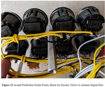

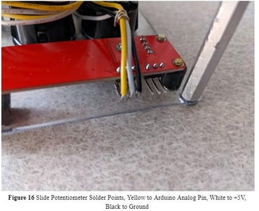

Step 8: Soldering
Steps for soldering the inputs to the board:
- Use color-coded wire to assist with identifying correct connections.
- The potentiometers have 6 pins[10], however you only need to make solder connections from the three pins shown to the microcontroller.
- Use the bottom 3 pins were to for best clearence on the rotational potentiometers.
- Connect the right pin of each pin to +5 from the microcontroller.
- Connect the middle pin of each potentiometer to a unique analog pin between A1 and A4 of the microcontroller.
- Connect the left pin to ground from the microcontroller.
- Connect one pin of each pushbutton to ground
- Connect the remaing pin of each pushbutton to a unique digital pin between D5 and D12 on the microcontroller

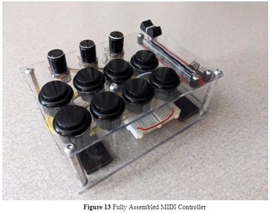

Step 9: Wiring and Frame Assembly
A schematic showing the connections of the MIDI controller is shown above. This schematic follows the layout of the actual MIDI controller in terms of pushbutton and potentiometer layout. The schematic is color coded and provides the pin connections of each component next to the components.
The connections to the Microcontroller are also shown.
Connection steps:
- Peel the away the film on the bottom of the breadboard to reveal the adhesive.
- Mount the breadboard to the bottom plate of the MIDI frame.
- Screw the standoffs into the top plate.
- Mate the two halves of the controller and put the screws in the bottom plate side.

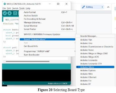

Step 10: Upload Code
Coding instructions:
- Download the Arduino IDE from the Arduino website [18], or launch the Arduino Web Editor [19].
- Connect the Arduino to a computer with a USB cable.
- Download the supplied program below.
- Open the program in the Arduino IDE.
- From the toolbar at the top of the editor, select Tools -> Board -> “Arduino Micro”.
- Then select the Tools -> Port -> “COMX” where X is the port your Arduino is connected to.
- In the event there are multiple options, it may take some trial and error. It will almost never be COM3.
- Then press the upload button to put the program onto the Arduino itself.
The Arduino is now able to be used with any music software as a MIDI input device.
