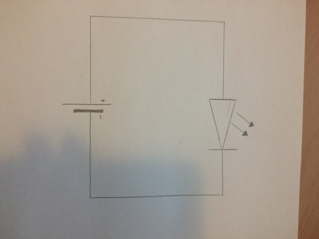

This build will work by putting a plug into a socket, so you don't have to worry about switching batteries all the time. If I would use a battery as a source of power, that battery would be quickly drained and then I would have to buy new batteries again and again. This way it saves me a lot of money.
I decided that I would use a LED, because I wanted the lightsource to be a strong one and it had to be energysaving.

In this step you will be connecting the LED with your plug, through the use of electric wires and electric duct tape.
Steps:
- Use a plier to cut away some of the conductive "plastic" around the actual copper wires of the electric wire.
- Connect one end of the wire by wrapping the wire around the ''outlets" of the LED. Solder the wires with a soldering iron, so you're sure the wires are secure and cover it with lots of electric duct tape. Do this so there won't be any electricity running through you when you put it in a socket (remember it's 220-240 Volts of electricity that's running throught the wire).
- Connect the other end of the wire to your plug. Do this by taking apart your plug, connecting your wire with the conductive parts of the plug and then reassemble your plug.
Once you have done all that, test if the LED is working by plugging it in.
