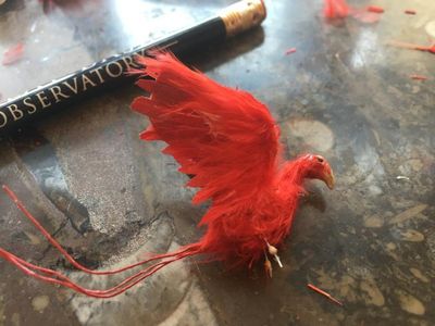

To make the eyelid, roll a long cylinder out of white or off-white clay, and cut two pieces off which are about twice as long as the diameter of the eye-hole. Place one of these above each eye, and, using an embossing tool, curve the cylinders so they resemble rainbows. Use the tool to smooth out the top half of each piece so it merges with the head (look at picture two for reference).

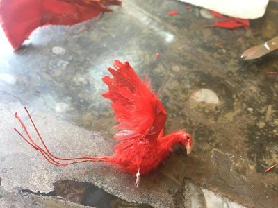

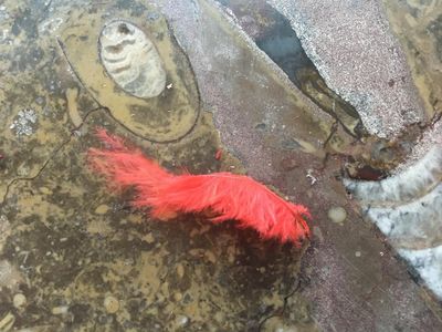

Take the fluffy part of one of your red feathers and cut off a small clump. Paint some tacky glue on to your bird, near the tail, and press your clump of feathers on it. Continue doing this, starting near the tail and moving up to the neck, until the entire body of your phoenix is covered. Then, trim off any feathers that are sticking up at weird angles.
Step 7: Feathers - Wings
Cut off part of the non-fluffy section of your feather (refer to the first picture), then trim it so it has the shape of a willow leaf. Glue it to the bottom of the wing of your bird. Repeat this until the entire wing it covered.
Hunt through your bag of feathers until you find a very small, entirely fluffy feather (they are usually attached to the bottom of larger feathers). Cut off all of the fluff from one side, and glue the remaining feather to the wing of your phoenix (refer to the seventh picture). Do this again, but this time make sure that the non-fluffy side of the feather is right against the edge of your wing.
Repeat all of these steps on the other side of this wing, and both sides of your phoenix's other wing.

Make about five more non-fluffy feathers using the same process as you did when you were making the wings, and glue them together (refer to picture two). Using super glue or hot glue, glue the group of feathers where the tail should be.
Optional: Glue more fluffy feathers around the tail to hide any visible glue, or just to make your phoenix more fluffy!
Cut three non-fluffy feathers into a raindrop shape. Mix gold pigment and tacky glue to make a sort of paint, and paint this mixture onto your three raindrop feathers, starting in the middle, and slowly fading outwards. Super glue the three feathers to the three wires that come out of the bird's tail.
