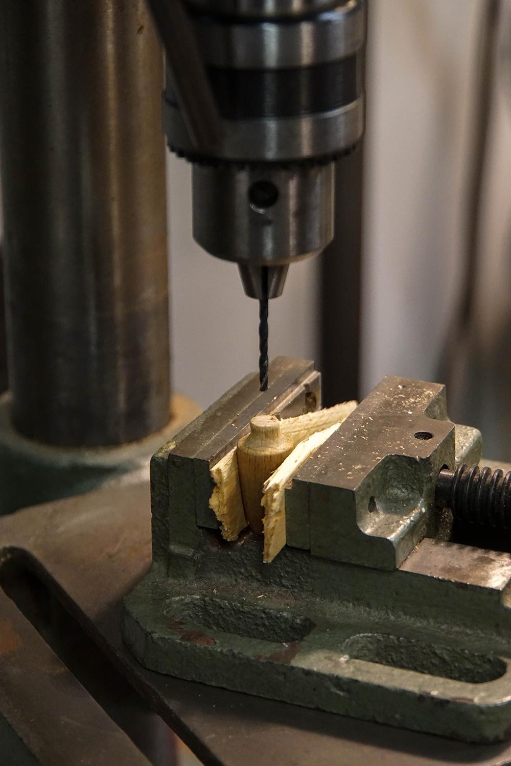

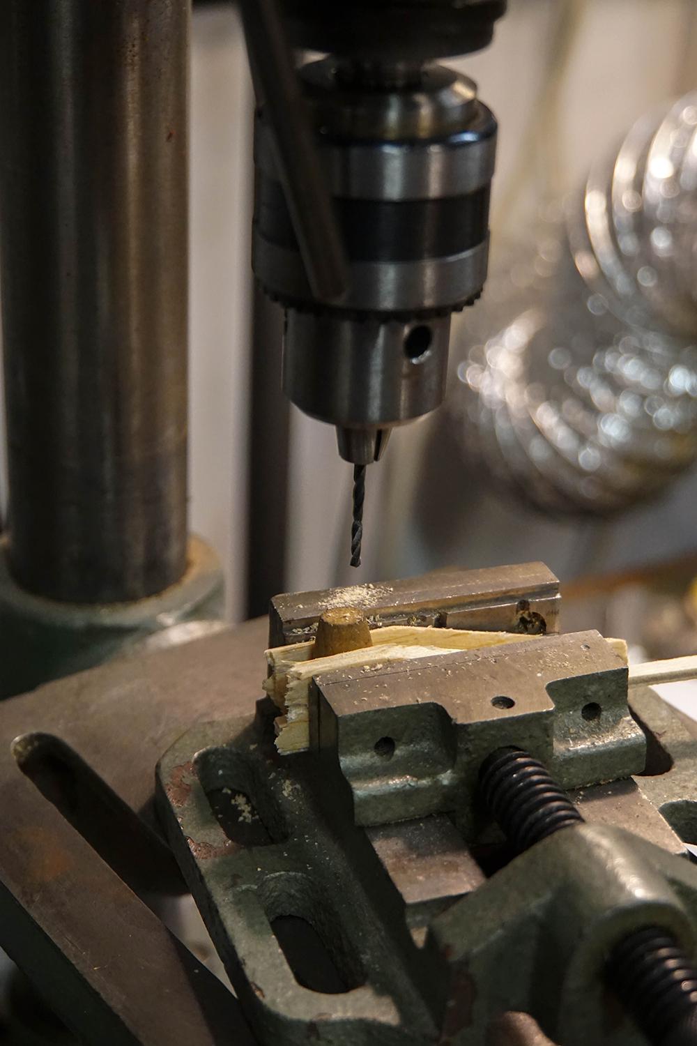

Step 2: Drill
You don't have to drill these pieces, but it gives you more options if you do; for the vase, it means you can put a little flower inside, and for the lamp it means there's the option to wire it up at a later date (or now) if you want a working LED lamp.
Clamp each wooden piece in position, line up the drill bit, and drill straight down. I drilled partway into the top of the vase using a 2 mm drill bit, trying to make the hole as centred as possible.
Then I drilled all of the way through the centre of the lamp (from both directions so the holes were easier to place in the centre at each end), and also into the back of the lamp so both holes joined up in the middle.
Use sandpaper all over these pieces to get a nice clean finish, and sand the ends flat. I used the 220 grit and then the 1000. Remember the breathing mask etc.
