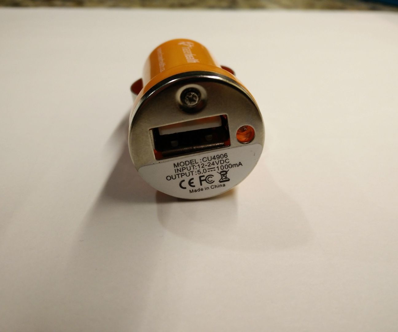

Shine an LED through the plastic to test it. If little light will pass through the material the night light will be useless. I have made three night lights for my kids so far. I have used a Hello Kitty shampoo bottle, a Lego lighthouse and a McDonald's restaurant Happy Meal Minion toy. Consider the base and how you want to power the nightlight. I started powering the night lights with three AA battery packs. This gave good portability however I was changing batteries every three to four months. I now use a 5 volt wall wart for power. These are quite common and you probably have an extra one lying around the house. Cell phone chargers are a common source.
