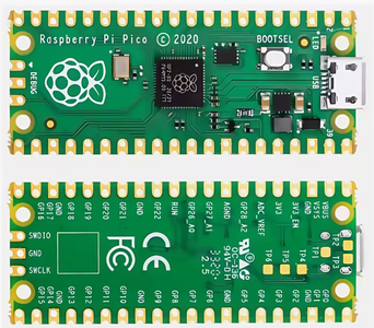

  1. Raspberry Pi Pico 2 (RP2040 chip) – about $6

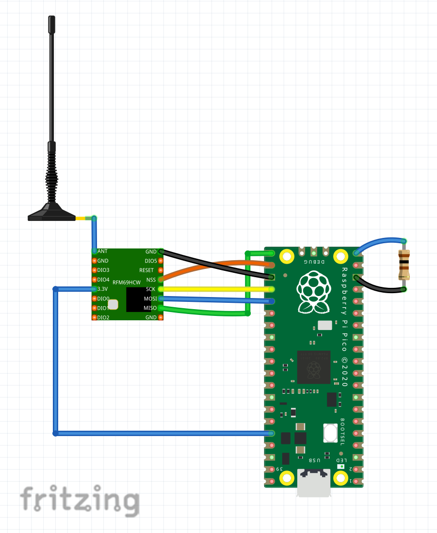

Step 1: Wire Everything Up
Now let's do the wiring part of the boards. My RFM69HCW already came with a coil antenna pre-soldered, other wise you will have to solder that part directly to the ANT pin.
Carefully check the wiring diagram to connect the correct GPIO pins on the Raspberry Pi with the module for the power supply (3.3V!) and SPI communication.
Optional: Adding a Dummy Load
Because I want to use this device with a portable power bank to do some range testing, I will be adding a 100 Ohms resistor as a dummy load between one of the GPIO pins and the ground. As the RPI2040 is too low power, it makes my power bank go to sleep after a minute, which I will prevent by drawing some current pulses from time to time on the resistor. For my power bank, it worked fine, you may have to tweak the values for the duration and interval of the current peaks slightly if it doesn't work for your power bank. Or maybe you don't need the resistor at all - if your power bank doesn't have a shutoff feature.
