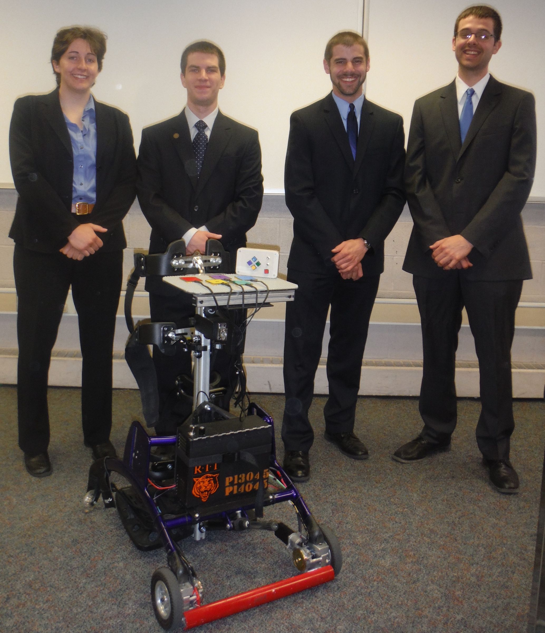

Introduction: DIY Mobile Pediatric Stander
Rochester Institute of Technology Senior Design Group 14045
Background: A motorized pediatric stander is a device similar to a wheelchair, meant to assist a disabled child to move around their environment in an upright position. The device should be able to provide safe, comfortable, and smooth transportation of the passenger, with the ability to be controlled by a third party. A previous prototype used buttons to control its movement, but the start/stop was found to be very jerky and the stander did not track straight. The remote control functionality was attempted, but was not fully implemented. Safety features were not fully developed.
Goal: Make interchangeable controls, tray system, wheel and battery box for a mobile pediatric stander. The accessories have to be capable with different models of the stander, and need to be self contained.
Components for Build:
- Tray System
- Wheel System
- Battery Box
- Controls System
- Bill of Materials
*Images courtesy of the Democrat and Chronicle
