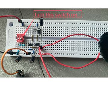

Step 1: Please Refer to the Following Circuit Schematic and Breadboard Layout to Build the Circuit
It is important to note that C1, C2, C3, and C4 are electrolytic capacitors. While they typically require correct polarity when connected to a circuit, they do not have polarity constraints when dealing with AC signals. However, in DC power supplies or DC signals, polarity must be observed: the longer lead must be connected to the positive terminal, and the shorter lead to the negative terminal. In this circuit, special attention must be given to C1 and C3 to ensure they are not connected in reverse polarity, as improper connection may damage these electrolytic capacitors during operation.
C1 serves as the charge-discharge capacitor in the bias circuit of Q1, while C3 functions as a decoupling capacitor connected in parallel with the power supply. The role of C3 is to quickly supply or absorb current when the circuit's load current fluctuates, preventing sudden voltage changes. By smoothing the power supply voltage waveform, the decoupling capacitor enhances the overall quality of the power source.
Step 2: Turn on the Switch S1
Once you have completed building the circuit according to the schematic and breadboard layout in Step 1 and connected a 2 to 3V DC power supply, turn the switch on. You will hear the speaker producing a sound similar to a motorcycle engine. The waveform of this signal is shown in Fig.speaker_wave.

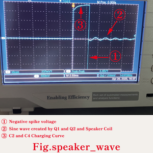

In Fig.speaker_wave, you can observe that the point marked ① represents a negative spike voltage, with a magnitude close to the supply voltage. This occurs because, when capacitors C2 and C4 are in the charging state, their positive terminals effectively act as ground. Although, theoretically, the speaker behaves like a short circuit in a DC circuit, it actually has impedance. As a result, during the charging phase of C2 and C4, the current primarily flows to the capacitors' positive terminals rather than directly passing through the speaker to GND—since current naturally follows the path of least resistance.
When C2 and C4 finish charging at the falling edge of the waveform segment marked ③ in Fig.speaker_wave, transistor Q1 turns on. Since one end of C2 and C4 is connected to the base of Q1, when Q1 turns on, its base-emitter junction becomes forward biased. At this point, C2 and C4 effectively have their negative terminals grounded, causing their negative voltage to drop to 0V instantly. Due to the capacitor's inherent characteristic of resisting sudden voltage changes, a sharp voltage drop on one terminal will induce a negative voltage spike on the other terminal. Consequently, when the negative terminal of the capacitor suddenly drops to 0V, its positive terminal generates a negative voltage spike close to the supply voltage (in some cases, the peak negative voltage can be up to three times the supply voltage). This explains the waveform segment labeled ① in Fig.speaker_wave.

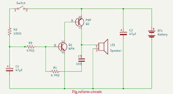

Result 1: As shown in Fig.reform-circuit, we made a slight modification to the circuit by adding a resistor R1 in series with capacitor C3.
Now, when the switch is closed, the speaker initially produces a sound but then quickly stops, as demonstrated in the video in step 5. Similarly, when the switch is opened again, the speaker momentarily produces a sound before falling silent once more.
The reason the speaker only emits a brief sound upon switching on or off is as follows:
When the switch is closed, the power supply charges C1 through R2, gradually increasing the base voltage of the NPN transistor Q1. Once this voltage reaches approximately 0.7V, Q1 begins to conduct and oscillate. (In real-world conditions, because electronic components are non-ideal, manually toggling the switch introduces mechanical noise—a signal containing a mix of frequencies—which acts as an input to Q1's base, triggering oscillation.) As a result, the speaker starts to produce sound.
However, the speaker does not continue to emit sound indefinitely. This is because, as C1 accumulates charge, the voltage across it eventually reaches a threshold, causing Q1 to enter saturation. Once saturated, Q1 loses its amplification properties, and the circuit effectively behaves like a DC circuit, meaning that the speaker is no longer driven and stops producing sound.

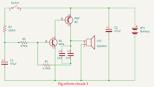

Result 2A: Adding a 103 Ceramic Capacitor (C4) in Parallel with C3
Now, building upon Fig.reform-circuit, we add another capacitor, C4, in parallel with C3, as shown in Fig.reform-circuit-1.
When the switch is closed, you will notice that as long as the switch remains closed, the speaker continues to emit sound. As demonstrated in the video in step 5, the complementary self-oscillating multivibrator generates an output signal at a frequency of over 500 Hz , which drives the speaker, producing a sound similar to the operation of a CNC lathe.
Why does the speaker continuously produce sound after adding a 103 ceramic capacitor in parallel? This happens because the RC frequency selection network's frequency has changed. The newly selected signal frequency can now propagate through the positive feedback network to Q1's input, allowing the circuit to maintain oscillation indefinitely without the need for an external input signal.
From the oscilloscope display in the video in step 5, we observe a spike voltage reaching 13V in the negative half of the waveform's coordinate axis, which is significantly higher than the 3V power supply voltage.
Why does the circuit generate a voltage four times higher than the supply voltage? This phenomenon arises due to two key factors:
Capacitor voltage stabilization – Capacitors inherently resist sudden voltage changes.
Inductor current stabilization – The speaker coil acts as an inductor, which resists rapid current fluctuations, indirectly manifesting these effects as voltage variations.
The combination of these two properties results in spike voltages far exceeding the supply voltage. If the speaker’s inductive effect were absent, the capacitor-generated negative voltage would be approximately equal to the positive peak voltage, as seen in Step 4. In this specific circuit, the observed negative peak voltage closely matches the power supply voltage.
