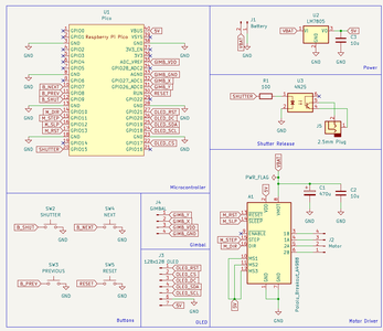

Step 1: Electronics Build
See the schematic for the needed connections between components. There are around 2 dozen connections to be made here which makes most assembly methods possible. The second image shows the whole project implemented on a breadboard for testing.
You could transfer the electronics to a perf board and be done with this step. Since I have a 3018 CNC machine, I decided to go a little farther and cut out a PCB: If you want to use a CNC, chemical etch, or order a manufactured board, you can find the needed files in the motor_rail_kicad/ directory.

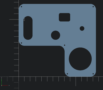

Step 4: Controller Case
I'll start by saying you can download an already-exported model you at 3d_models/stl/controller.stl. The rest of this section is if you want or need to customize the case.
In the folder 3d_models/controller, there is a file named controller.scad, which can be loaded into OpenSCAD. The model is parametric and has many variables you can change and experiment with. The bottom of the file allows you to turn components on and off using the standard OpenSCAD prefixes of *, ! and //:
// comment out everything but controller for the 3d print model
controller(false);
placed_pcb();
placed_gimbal();
cover();
// comment out everything but this to create a dxf projection
//cover_projection();
The cover_projection() can be used to create a DXF export for CNC or a laser cut. Alternatively, you can 3D print the cover, likely with some modifications to allow the screen to be viewed:
An exported DXF is available at 3d_models/dxf/controller_cover.dxf if you would like to use that as your starting point.
