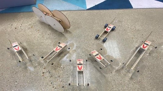

We first decided to build a control car with lengths that are normal than we built 6 different cars using different length body's, different length wheels, and different length rods to figure out with car has the fastest velocity.

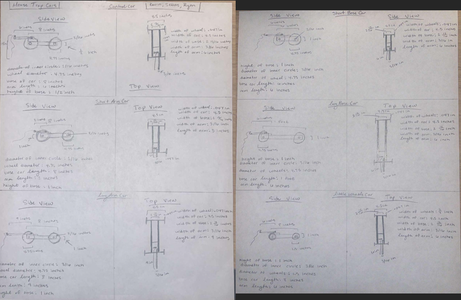

Week 2 was drawing our sketch, props to Kevin and his amazing sketches, we felt ready to start building the control car. we bought our supplies at hobby lobby and got to work!

Coming down to last few days of week 4, we were planning on buying Vinyl's for our "large" wheels but that would be a lot of money so planning it out, there is this workshop at National Park College called "The Makerspace" where we decided to use a 1/8 of an inch of plywood for the wheels. We used a laser cutter to carve out a diameter of 7 3/16th inches as our wheels.

After Testing every car, we came to conclusion that the "Small wheels" car won due to its low weight, fast moving speed!
Any advice we have for you guys at home making mousetrap cars is when making the holes for the axels, make them line up with each other because unfortunately we didn't for much of the cars, making them curve A LOT just like the short body one down below.
