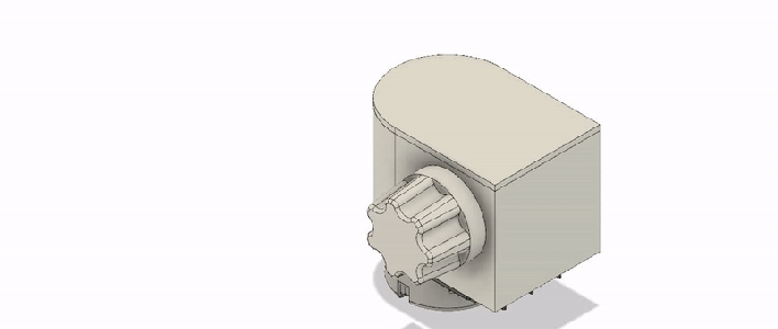

Step 2: Working Principle (Worm Gear)
The device which we are going to build will be working on the principle of the worm gear mechanism.
In the worm gear, there are two parts, one is a worm wheel and the other part is the worm gear.
As can be seen in the animation above when the knob is rotated, the worm gear rotates which rotates the worm wheel and thus the potentiometer shaft rotates.
The benefit of the worm gear is that it can provide very high gear reduction in a very small space, but it comes with a drawback that it can't be back driven means the worm wheel can't rotate the worm gear. In our case, this drawback doesn't harm us.

Step 5: Assembly
This is the assembly guide for reference purpose.

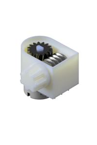

Step 7: Insert Gears
Now we need to insert the gears into their place.
First insert the worm wheel(gear with the D hole) into the potentiometer, then insert the worm gear into its place.
If the worm gear is fitting rigidly into the body, then first sand it using some sand paper or file.
Step 8: Insert Pins
To lock the gears and provide a shaft to rotate them we will insert pins into the worm gear, I have chosen two pins as one pin was getting loose after a while.
Yes, I could have used some sort of glue to fix the shaft but I tried to avoid glue for this project and made everything mechanically assemblable.
Two pins will not rotate on their own axis rather they will help in rotating the gear.
