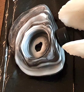

Step 6: Make a Magnetic Cup Holder Feeding Ledge
Alright, on to the feeding ledge! You can buy these commercially and that's probably easier, but what's the fun in that?
You're going to need your feeder cup and terrarium magnet for this. The magnets have polarity, so stick the plain magnet together with the one that has the black cap, and on the plain magnet mark the side that wants to join with the other magnet. I put an X on mine with a sharpie.
For these I used some of the colored pellets, so we'll get into techniques for that but first the basics of how to make the shape.
Heat a few separate piles of pellets. You can pour a couple of little separate clumps of pellets on opposite sides of your pot.
With one bunch of pellets, make a fairly thin layer to wrap around your feeder cup. I know I warned you about touching the hot moldable plastic to other plastic, but this seems to be fine, they don't stick together. Because I was keeping tropical reptiles and there was a lot of moisture, I left the bottoms under the cup open so water would run out easier.
Form your second bunch of pellets into a sort of strip, and wrap it around the existing plastic, building it up into sort of disc shape. (See the second photo above.) Keep doing this until you have the sort of shape you want. Make sure it's big enough for the reptile you want to use it with to sit on it while they eat!
With your fingers, flatten the side that you want to place against the glass, and press the magnet in. Make sure that the side you marked -- the side that wants to attach to the opposite magnet -- is facing OUT.
Now take that side where you've inserted the magnet, and press it against a flat surface to truly flatten it out. That will help it sit flat and level against the glass when you place it in your terrarium.
Let it cool a little, then pick it up while it's still a bit pliable, and pull a little bit of the plastic down over the magnet to hold it in place.
For the first one in the photos I added quite a few black pellets and ended up with basically a black shelf. For the marbled look in the second shelf, I had two separate piles of pellets: one just white, and one colored with a couple of pellets of black. I layered them over each other, folded them over each other again, then created the ledge as detailed above. That gave me the marbled look in the last photo above.
To finish the ledge off, I recommend a thin layer of silicone applied to the side of the ledge that will be against the glass. That will protect your glass from scratches, and also add some additional traction to hopefully keep the ledge from rotating. If you have larger animals, like adult crested geckos, you'll need to make the shelf much bigger, so use two magnets on opposite ends.
