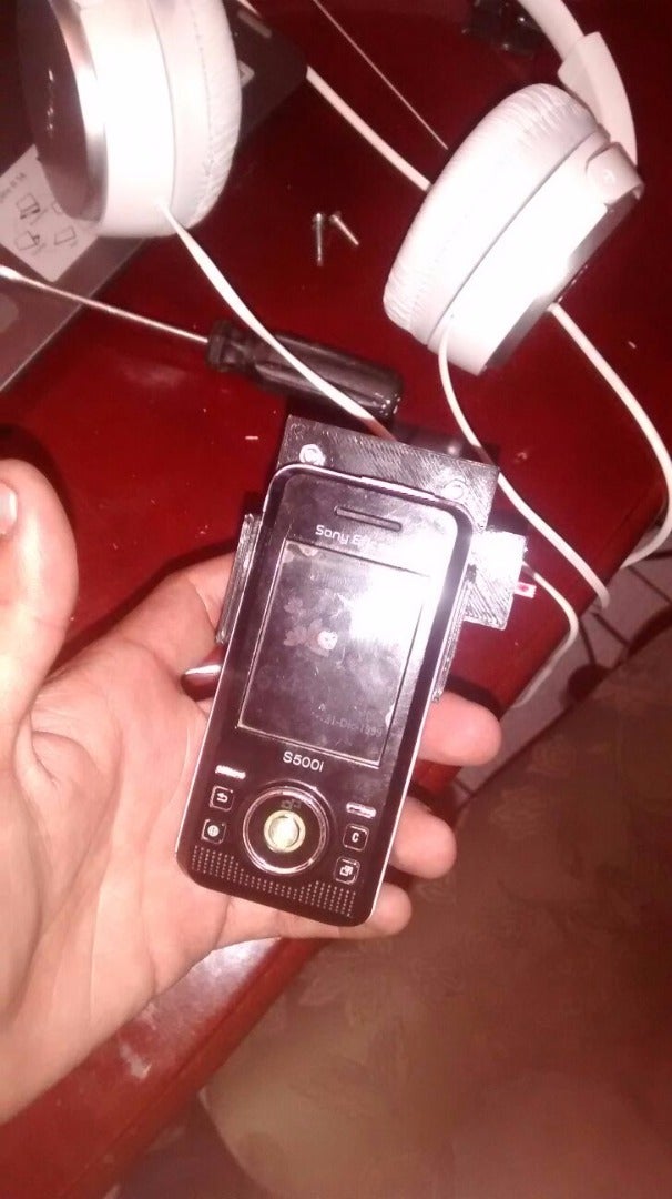

Step 5: Infrared Board Led
Here we are going to make like a base, in a perfored board set 9 infrared leds and do an adjustment to make them in serially at 3.6 volts .Maybe you will need some welding skills and know something very basic about electronics.
Step 6: Led Base
In this step I made a 3D design to have the led board in place and adjust it to the cellphone cover.
The led board is directly connected to the cell battery and it fits perfectly into the 3D base, just to make it easy and trying not to damage the battery a switch was added to the design to turn on/off the infrared leds.
Step 7: Final Result
At the end if you follow all the steps you will have your night vision camera in a cell, something like this...
