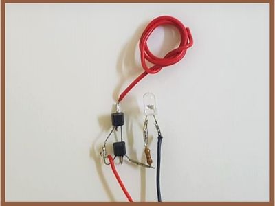

Step 2: The Circuit
The whole Circuit that we will be making is in the image above with the Crystal Clear circuit diagram
Make sure you check it out. I am providing some tips for you to solder the Circuit -
- Keep the wires from your components short so that they don't take up much space and can be enclosed in a bottle cap
- You can take out one old Battery connector from a used up 9V Battery and directly solder it to the circuit to save space and some pennies too for your next project

With this our Non Contact Voltage Detector is Ready to go for some testing and some Detection.
Step 4: Testing Time
Our Non contact Voltage Detector is ready to go. Just Connect a 9V Battery and take it near some wire from the Socket
You will observe that the more nearer you go the Brighter the LED gets
This thing is going to ease your way out while checking any voltage in any wire or circuit without ripping off any of its insulation and the using the multimeter
