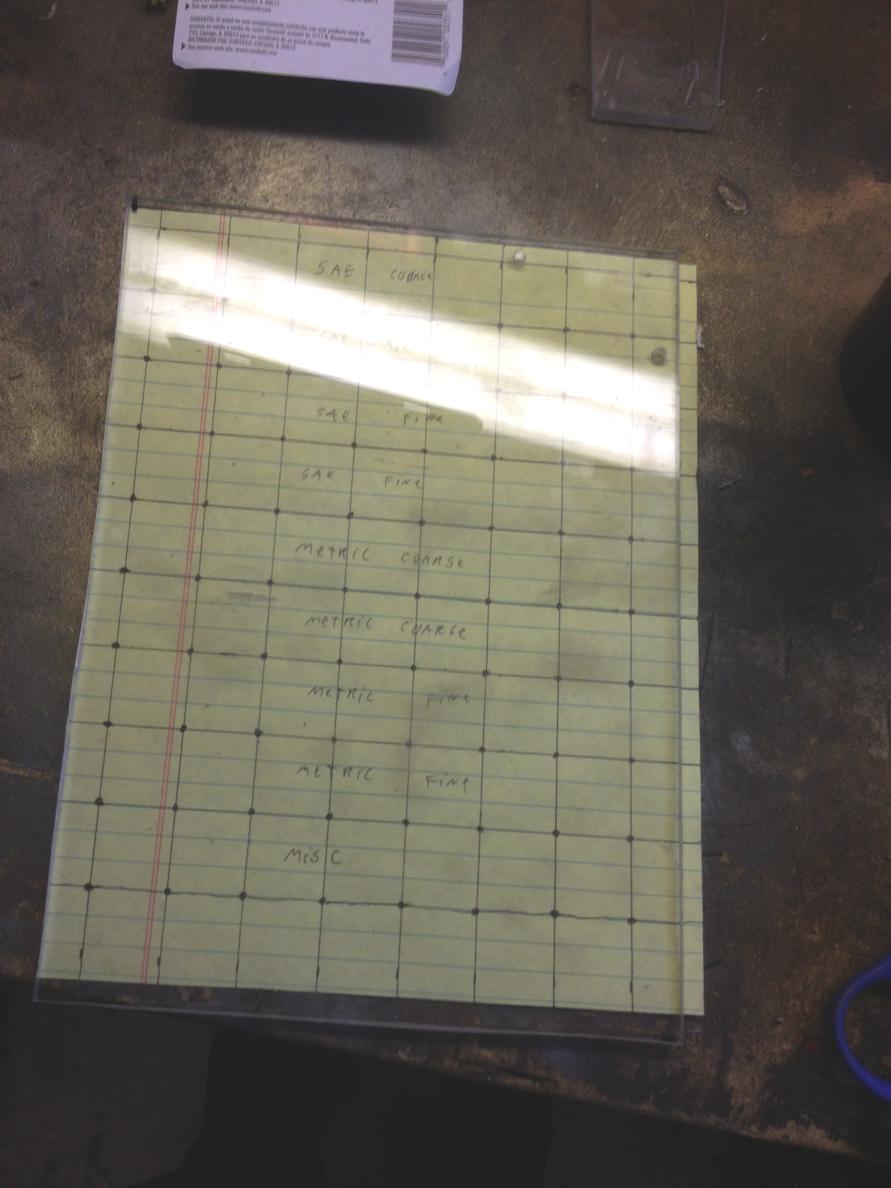

Step 1: The Layout
The first thing I did was cut my plexi down to size. I've had mixed results doing this in the past but this time I managed to get a nice clean break. I could have used wood for the base or metal, but I had the plexi on hand so I used it.
Once I had it cut down to size my next issue was how to mark my layout without marking the plexi itself. The benefit of using the plexi came in nicely here. I just took a piece of paper and laid out a 1" x1" grid pattern on the paper and set it under the plexi on my workbench.

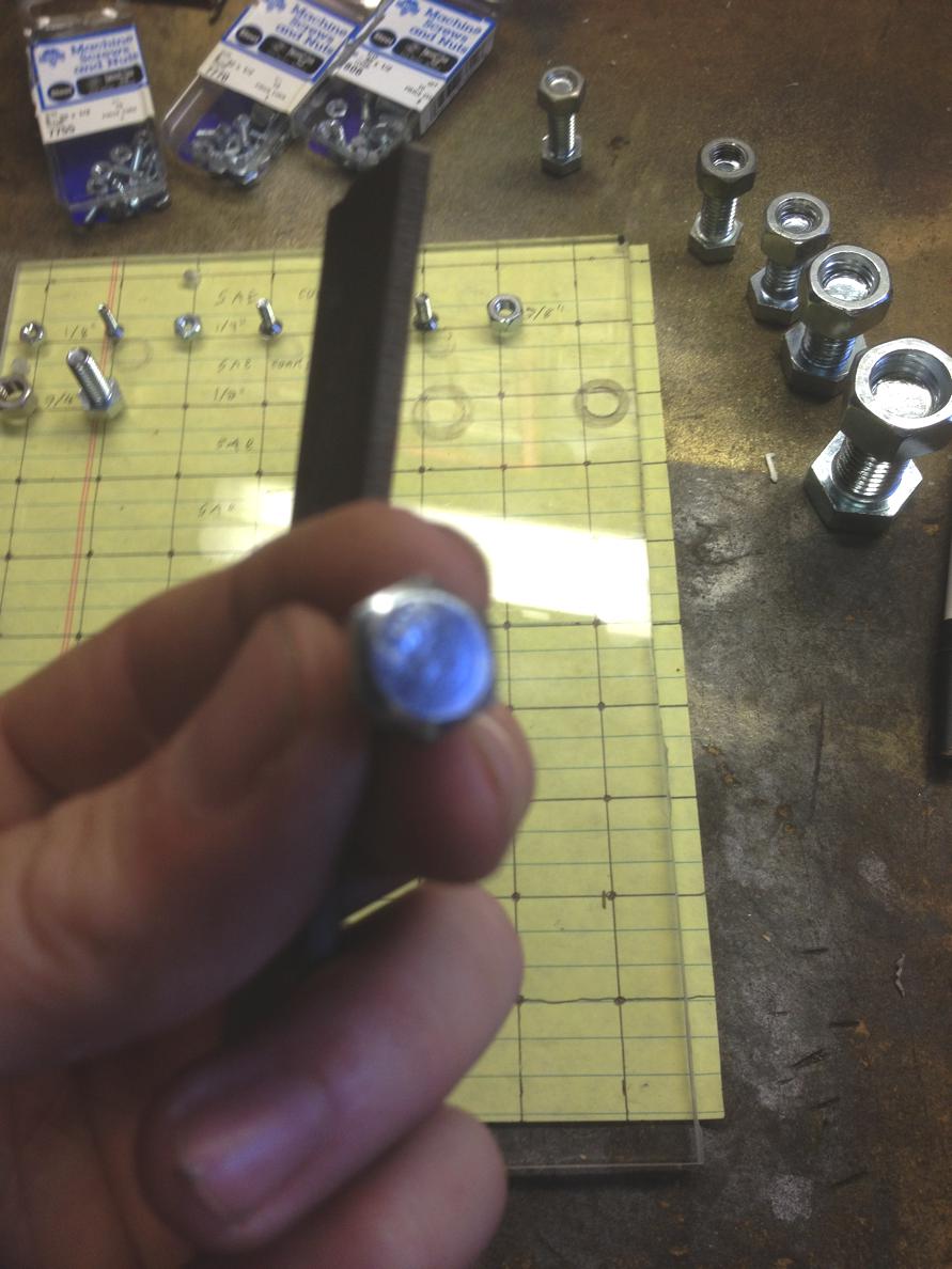

Step 2: Prepping the Hardware
The issue with glueing the bolts directly to the surface of the plexi is that most bolts are not flat on the heads. They come with grade or manufacturers marks cast into the heads. Obviously to ensure a secure bond, these needed to be eliminated. I just used a hand file and filed the heads down nice and flat. This has the added benefit of scuffing the surface to ensure a good strong bond, so I filed the nuts a little bit as well.

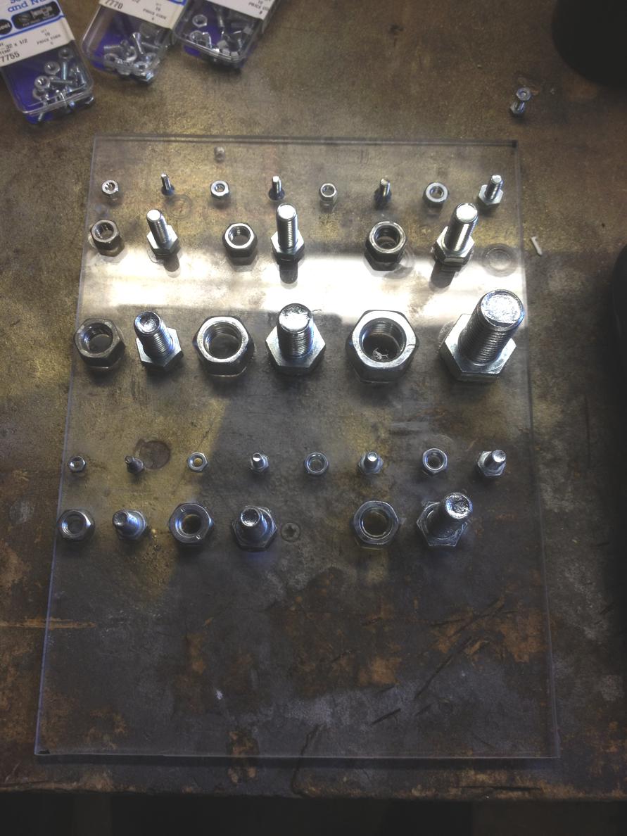

Step 3: Putting It Together
Next I laid the hardware out on my grid on the plexi. I had to make a few adjustments here for the larger nut and bolts. Luckily I did a dry lay out the first time before I glued them down to make sure I was going to be happy with the placement. Once I was, I picked each nut and bolt up and glued them in place one at a time.
For the smallest nuts, I found it worked well to use the bolt to help hold it in place as I was setting it. Just be careful not to glue the nut and bolt together by accident.
A Note here on the Super Glue, I choose to use it since I had some on hand. I did a strength test by gluing a half inch bolt to a scrap piece first. I was not able to easily break it off so I am fairly confident it will hold up just fine. Long term, well time will tell. If it ever does give I will re-set with a good 2 part epoxy.
