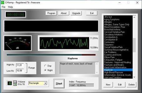

  First, as a PEMF signal source I use my PC with the "CHIamp" software created by Ken Uzzell, which you can download for free on the spectrotek site. Unfortunately, there software is in .exe format and the anti-virus program detects it as a virus, but after I downloaded it, I scanned it with multiple anti-virus programs and it turned out to be clean. CHIamp is Inspired by the Infratonics instrument. Application contains predefined programs for several diseases, but we can also create our own custom program. We can change the intensity of the signal, then the shape of the signal, and here the duration of the therapy.
  From the Line Out output of the sound card, we bring the signal to the input of the device, and start the program. Next we move the potentiometer to a certain degree and as we see the meter responds. If we get closer a magnet near the coil, it oscillates with the frequency set in the application.

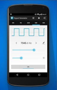

  Instead of a personal computer, we can use as a source of PEMF signal if we have a commercial PEMF device with an output signal port, or simply an android smartphone with a Signal Generator application.
