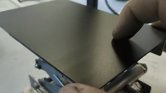

First, I degrease the metal side of the workpiece and paint it with black paint.
After the paint has dried, I put the workpiece on the work table.
