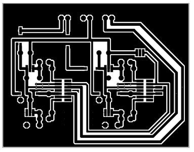

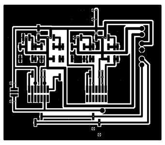

1.4 PCB Layout
After completing the schematic, switch to the PCB layout view. Here, you will:
- Place Components: Position the physical representations of your components on the PCB. Pay attention to spacing and orientation to ensure ease of assembly and functionality.
- Route Traces: Draw the copper traces that will connect the components. Aim for the shortest and most direct paths to reduce resistance and potential interference.

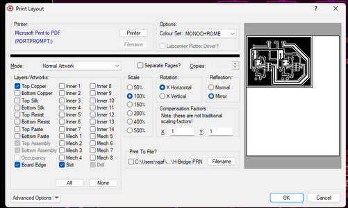

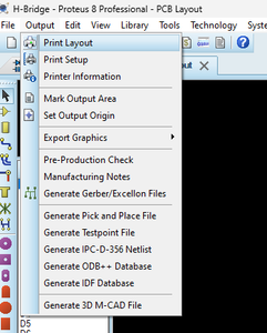

Step 2: Export the Design
Once you’re satisfied with your PCB layout, export the design files. Typically, you will need to generate Gerber files, which are the standard format for PCB manufacturing. Additionally, export a PDF of the layout for use in the toner transfer process.
Now you will print this layout on a photo paper using a TONNER PRINTER.
Note: it is important that you use a Tonner Printer and Glossy/Photo Paper.
