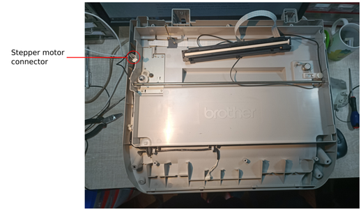

I remove the control panel (the part with all the buttons) which allows me to then remove the glass part giving access to the axis and allows me to locate the stepper motor.
I can now remove the motor and gear-reduction-plate to see in what direction the wires of the motor are going.
I open the side panel behind which the ā€œbrainā€ of the printer is located (it is most likely the panel with the USB port)
I unplug the motor cable from the mainboard of the printer, and I feed it back toward the motor and I get the motor cable at the top of the machine

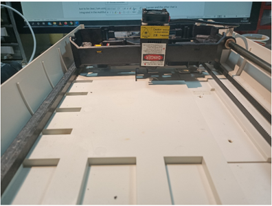

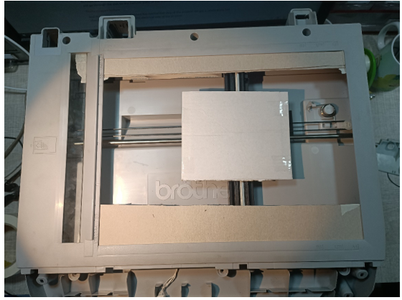

Now, I need to prepare the cutting bed. You can see on the pictures, the way the tray of the scanner is guided in its motion, there are spring loaded wheels pressing on the glass and the tray is pressed down on the metal rod. For our purpose however, we need to remove the glass plate…
The solution I have chosen is to remove the glass but to keep the tray from wobbling, I have taped quite rigid cardboard in place of the glass but only on the path of the wheels giving me some space to work with for the movement of the cutting bed. This works just fine but a best way to proceed is probably to get either strip of glass or wood of same thickness as the original glass.
The cutting bed itself is a piece of cardboard which is not ideal but I have to keep the bed light. Just keep in mind that the bed is a sacrificial bed

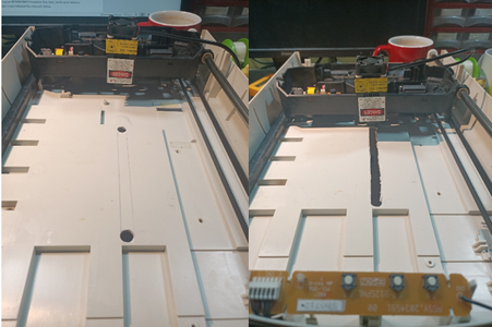

The steps are similar but easier on the standalone scanners (and I forgot to take pictures of the dismounting of my scanner, sorry) The scanner and the printer will be stacked with an (eyeballed) 90° angle. To mount the laser, I have drilled mounting holes on the side of the scanner tray as for the laser to be located in the middle of the tray and pointing down. Before actually mounting the laser on the tray, we need to cut a slot on the bottom panel of the scanner for the laser beam to reach the cutting bed below. I have drilled 2*10mm holes and then finished the slot with a Dremel equipped with a general-purpose cutting wheel. You can also use a manual saw instead of a Dremel. I then mount the Laser on the tray making sure that the laser is aligned with the slot on the bottom plate of the scanner.
And that is it! We have now finished the mechanical step of the project! Go get a celebratory hot chocolate and let’s move on to the electrical side of the project!
