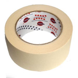

6. masking tape (any size will do)

First, you'll want to place masking tape on the parts you obviously don't want painted.
The small end of the battery cover and back shell are attached as one piece so it's best to cover the small battery cover end with tape. If you can't the shape with the tape the way you want, use the razor to trace out the parts of tape you want to cut off nice and evenly. make sure to cover you camera lens and flash with tape as well.
