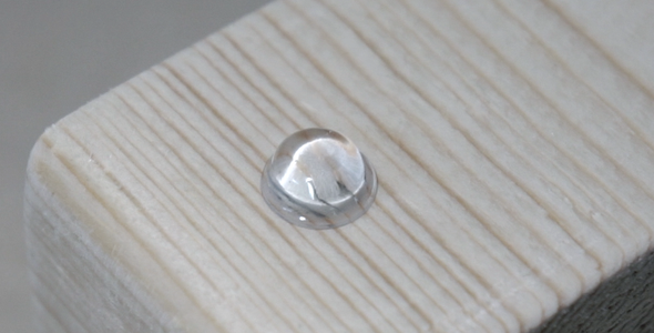

Attach door rubber bumpers to prevent scratching floors etc.
