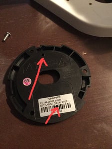

Picture #1.First take the camera cover and assembly apart so you'll end up with the black round plastic part that is supposed to be screwed to the ceiling.

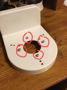

Screw 3 of the provided screws as shown (picture shows 4 screws but you only need 3) in the picture and place the black round plastic upside down. Flip both of pieces together and drill thru the hole that's missing the screw using the 3/16 drill bit and then remove the screw from the opposite side and use that screw to hold the black round plastic to the bracket in the same way (upside down) and now drill the hole where you remove the screw; this screws will help keep the black plastic centered on the bracket, repeat the same process on the other two screws so that you end up with four screws aligned to the right holes on the bracket just like the last picture.

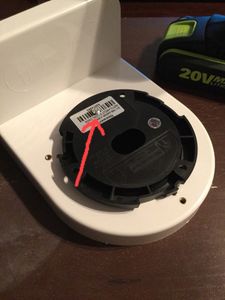

Place the assemble motor housing on the white side of the wall bracket/black plastic that you assemble before and center it on the hole (the hole will be about 1mm too small all around) and use a marker to outline the area to be sand away using the sanding drum attachment on the Dremel tool, make sure to check constantly so that you don't take too much plastic off and end up with a larger hole that will be hard to fill, I used a hole drilling bit to remove the excess plastic faster and the used the sanding drum to make the hole the right size.

Pic#2 use a piece of heat shrink tubing to secure and protect the wires and plug that connects to the logic board.

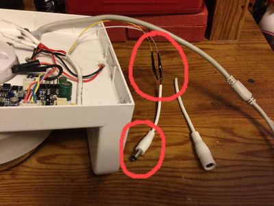

unplug the cable from the camera and we'll need to cut the power wires (black and red) that plug on the IR logic board as far away from the plug as you can, this should leave enough slack to allow the camera to rotate from side to side without damaging the wires. You shouldn't cut the wires going to the camera logic board.
Pic#3 splice the black and red wires from IR plug and electric bracket together (black to black and red to red), splice only the red LED wire but leave the black LED wire alone (on the pics #3 & #4 you can see I spliced the black LED wire but that's wrong, on pic #5 you notice that the red LED is actually spliced with the red wires)
Pic#4 use heat shrink tube to protect the connections.
NOTE: the yellow and white wires won't be connected to anything at this point, however those two wires are attached to the electric bracket plug.

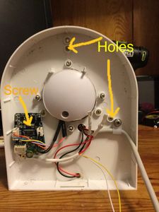

Step 5: Set Up Logic Board and Camera Assembly
Pic#1 set the electric bracket logic board on the wall bracket (inside upper compartment) and use a screw to attach it to one of the holes on the wall bracket, just make sure the head of the screw doesn't bridge any of the electrical parts/surfaces and add a drop of hot glue to hold it in place; also put a drop of hot glue in every one of the wall bracket holes.
Pic#2 drill a hole for the LED running from the wall bracket compartment to the bottom and run the LED through the holes, the LED should fit tightly on the bottom hole so the it won't move out of place.
pic#3,4 & 5 take the camera assembly and remove the metal bracket, on the camera side of this bracket cut off both sides between both screw holes so that there will be only one hole on each side to screw the metal bracket back to the camera assembly.
pic#6 align the metal bracket on top of the electric rotating platform making sure its pointing straight and its centered before using the epoxy to permanently glue the parts together ( note the way the metal bracket is layed and dry fit it with the camera to make sure the camera will be free to rotate inside the dome enclosure.

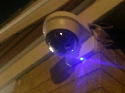

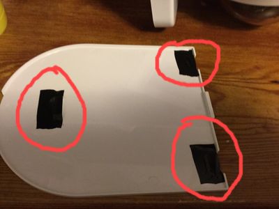

Now connect and test the unit and make sure everything works (pan, video feed and LED), use black electrical tape to cover the openings on the wall bracket cover (pic#4 )
Use the flexible adhesive to seal all the gaps and openings as noted on pic #6 & #7(around the dome assembly).

Now that your unit is assembled and working, mount it and brag about it to your neighbors and friends... And everyone passing by while you mount your new camera.
