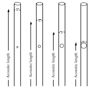

To determine the note(s) that a flute plays, you must adjust the total length of the flute as well as the position of any holes you have.
This flute acts as a vibrating resonant column of air with one open end and one closed end, which we call an closed-open pipe. To determine the length of closed-open pipe, you can usually use the following equation:
(Effective Length) = (Speed of sound)/ 4*(Desired frequency)
HOWEVER, in our experimentation, we have found that this equation does not accurately predict the length required to play a certain note for this particular design. This is likely due to the non-traditional mouth piece design and the many tuning factors. Additionally, it is possible that the flute does not fully act as a closed-open pipe (also due to the non-traditional embouchure).
