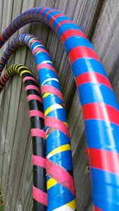

Step 5: Decorating
Now comes the fun part! Decorating! Not just to make your hoop look pretty but it also gives your hoop grip; otherwise it would be very slippery and hard to keep up. Grab your colorful electrical tape. You can use duct tape ,but it is harder to work with and will be bumpy. There are many different ways you can do this. You can use just one color; you can criss cross two colors. Decorate it how you want it to look. To make it how this one is made start at the inside of the hoop and have the tape at a slant and bring the tape around and around until you reach were you started. Then do the same thing with your other color but start in between the stripes you just made.
Step 6: All Done
And you're done!. I hope you enjoyed this Instructable. If you make one, post a picture in the comments. I would love to see how you decorated it. And if you have any questions, post them in the comments as well. Have fun & don't forget to vote :)
