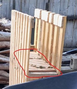

Step 2: Assemble the Rack
- Join the pallets back to back using some of the wood you just cut off the pallets. This will form a "cradle".
- If you like, you can have the lower joining pieces longer than mine for extra stability, but I've had no problem in all the times I've used my Rack.
- Fit your "sacrificial" board(s). It doesn't need more than a couple of screws, but make sure they don't go where the chainsaw teeth will go!
- You will need this to stop stuff falling into the bottom of the Rack.

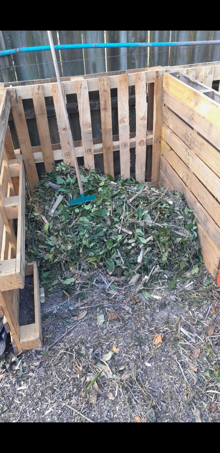

- You should see the original mass of vegetation reduced by half or more. Rake it out into the wheelbarrow, or onto a tarpaulin, or even just onto the ground.
- Repeat these steps until you're finished.
- Pile it all into your pallet-made compost bin.
Instead of composting the results, you can cut bulk material down to the point you can use it as rough mulch. At the very least it would enable you to cut the brush into smaller, straighter lengths (say 300 mm) for feeding into John Pedersen's shredder (https://www.instructables.com/Leaf-Mulcher/)!

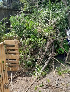

Step 4: Techniques for Vegetation Mulching - Leafy Branches
This is much the same as Step 3, but the branches will probably overhang more at both ends.
I was surprised at how much the large pile of shrubs was reduced!
- Pile the branches into the cradle and pack them down.
- Try to reduce the overhang at the wheelbarrow/tarpaulin end.
- Trim Step 1. As shown in the photo, the leafy overhang is tightly packed and can be sliced into 100mm pieces where they protrude over the wheelbarrow/tarpaulin.
- Place any long pieces back in the cradle.
- Trim Step 2. Cut off the thicker branches at the other end of the cradle.
- Place them back in the cradle.
- Cut the stack between each of the fingers.
- Do a couple of cuts at either end of the cradle, then make all the other cuts in between.
- This helps prevent long bits falling off one end.

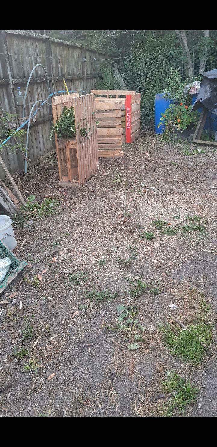

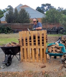

Step 5: Firewood Cutting
I've done a lot of this, usually bent over while steadying each log with my steel-capped boot. One then has to bend over again to pick up the cut wood and load it into a barrow if one is not within reach of the firewood stack.
The Chainsaw Rack solves all this. As you'll see in the Step 7 video, I can cut a wheelbarrow-full in less than three minutes!
- Position the Rack so it is stable and easily loadable from the branch pile.
- I placed mine at 90 degrees so it was only a very few steps from the pile to the Rack. Allow enough room for wheelbarrows.
- Place wheelbarrow(s) at the end(s) of the cradle.
- Load the cradle.
- The logs can hang over both ends of the cradle if they are long. This is a variation of the Trim Step that takes into account the weight and length of the logs.
- Trim step: cut off both overhangs.
- This can be done in suitably-lengthed pieces or cut them long and add them to the top of the cradle.
- If you cut gashes into your wheelbarrow, don't blame me!
- Cut the logs into firewood lengths.
- In my case this is three cradle fingers wide (so two cuts)
- You may occasionally have a pause if an unsupported branch pinches the chainsaw bar. This should not happen if you keep the saw at full speed, and is easy to release anyway.
- A small log may skip if it's at the top of the cradle, but as you'll see in the video, the cradle catches it for the rest of the cut.
- Throw all the pieces into the wheelbarrow(s).
- All without bending over!
Sometimes a firewood log is too knotty to split and needs to be chain-sawed into manageable chunks. The Chainsaw Rack is perfect for this as it holds the log safely and at an efficient working height.
If you want, the firewood can be any multiple of about 10-15cm instead of fireplace lengths.

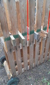

Ladder frame:
When you make a cut, you risk cutting right through your sacrificial board. You can reduce that risk by slotting short boards in every slot except those you'll cut in.
A cutting "ladder" frame is worth building though. This has cross bars screwed to runners and is a loose fit inside the fingers. The cross bars line up inside each finger. This cutting frame can lift in and out on top of the sacrificial board and can therefore also be used for both logs and garden waste.
It is simple to make, but remember to fit a cleat at the end opposite the wheels: when you move the Rack, you really don't want it sliding onto your shin!
As you can see from the photos, you can easily tip out the cut vegetation by simply tilting the ladder from the wheel end of the Rack. I've not tried this tilt technique with logs yet, and they may end up going everywhere
You will have to remove the wooden "fingernail" boards at the top of the fingers though: best to do that in Step 1.
Cutting limit stripe:
To know when you're getting close to the ladder frame runners, paint a broad line just above the ladder runners. When your chainsaw is in this zone - stop cutting!
