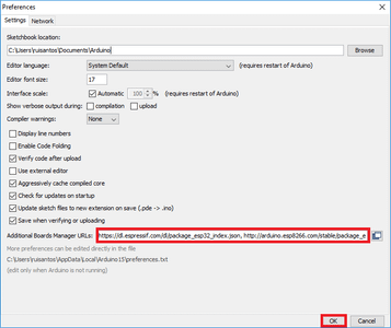

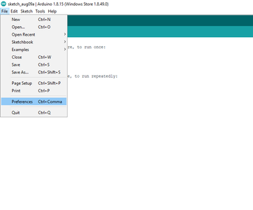

Step 5: ​Setting Up ESP32 Development Board
You can program the camera module using the Arduino IDE. After you have installed the development environment, you can open it to prepare you for using the camera module.
1. Start Arduino IDE and open the Preferences window.
2. Enter https://dl.espressif.com/dl/package_esp32_index. into the File>Preferences>Additional Boards Manager URLs field of the Arduino IDE. You can add multiple URLs, separating them with commas.
3. Close this window with the OK Button. Open Boards Manager from Tools > Board menu and select the correct ESP32 Cam board.
