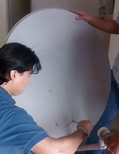

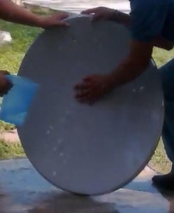

Step 1: Preparing the Satellite Dish
The first step is to clean and prepare the satellite dish. Remove any bolts or attachments and make sure the surface is free from dirt and debris. This will ensure better adhesion for the mirrors.

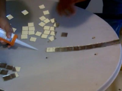

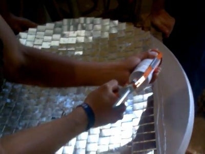

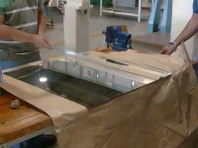

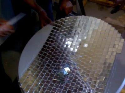

Step 2: Cutting the Mirrors
Using a glass cutter, carefully cut the mirror into small 3cm x 3cm squares. These will act as reflective surfaces to concentrate the sunlight onto a single focal point.

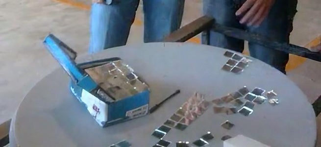

Step 3: Attaching the Mirrors
Apply silicone adhesive to the back of each mirror piece and stick them onto the satellite dish. Arrange them as close together as possible to maximize reflection. Allow sufficient time for the adhesive to dry completely.

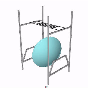

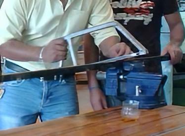

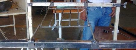

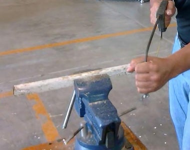

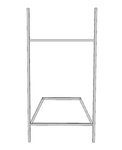

Step 4: Building the Frame
The frame can be constructed in various ways, depending on the materials available. We designed ours according to the schematic shown. Start by cutting the square steel tubing to the required lengths.

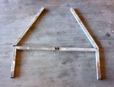

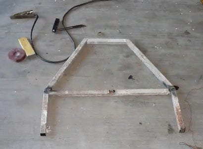

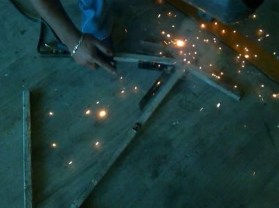

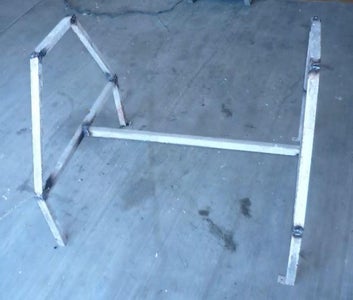

Step 5: Welding the Frame Pieces
Using a welding station, join the steel tubing to form the basic structure. This will serve as the support for the satellite dish.
Step 6: Completing the Base
Once the main structure is assembled, ensure the base is stable and level. This will prevent the solar heater from tipping over.

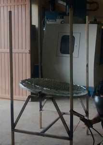

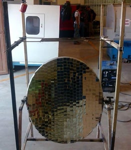

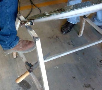

Step 7: Welding the Axes to the Dish
Weld two steel rods to the sides of the satellite dish. These will act as pivot points to allow adjustments to the heater’s angle.
Step 8: Attaching Bushings to the Base
Weld two bushings onto the frame where the satellite dish will be mounted. Secure the dish in place using a steel set screw to allow for adjustments.
Step 9: Finalizing the Structure
Continue refining the structure by cutting and welding additional pieces as needed. Since precise measurements aren’t required, you can adjust as you go.
