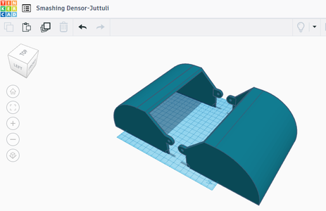

Step 1: Make a Design in Tinkercad
Creating a design for a poop scooper in Tinkercad can be quite straightforward. Here's a simple design:
- Handle: Start with a cylinder for the handle. Adjust its dimensions to make it comfortable to hold.
- Scooper: Create a flat, scoop-shaped surface that extends from the handle. You can use a combination of basic shapes like cylinders, boxes, and spheres to achieve the desired shape.
- Hinge: Consider adding a hinge mechanism so the scooper can open and close. This allows for easier cleaning and disposal of the waste.
- Supports: Ensure that the scooper has adequate support structures to maintain its shape and strength, especially if it's going to be 3D printed.
Remember to consider the size and weight of the scooper, as well as the material you'll be using for 3D printing is PLA.
If you choose not to create the design yourself, download the attached file and make the necessary changes.
