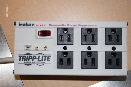

Step 8: Lighting Power Supply
A tripplite power supply under the table top to keep the work area clean.
Lights were covered with plastic light defuser.

Step 10: Lights Power Supply
- Philips lights bulbs were recommended by a tech.
- Tripplite power supply shown.
