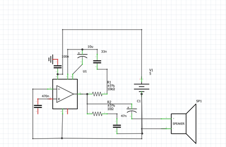

Step 11: Make an Amplifier 1/2
For this project to work we need two amplifiers and two speakers (in the case of a one-way communication). Now you could use more or less the same setup you used when making a transmitter, and while that would work great I'm not going to do that here because I'm gonna show you how to make an amplifier, so you can see that there are a lot of good ways on how you can make a fully functional photophone.
To pull off this build with easy-to-find materials I used a good old LM386 IC.

Step 12: Make an Amplifier 2/2
Start by placing IC somewhere in the middle of a PCB board and solder it from the other side of the board. Follow the schematics and do the same with other components.
While making this try to place all electronics components as close as you can to the IC itself (especially capacitor that goes to pin number 6 of LM386 IC) in the case of an LM386 this is important.
And also I made a short and simple circuit on a breadboard to test it out. That circuit works, but with just a few more components it works even better and it is simply more reliable.

This step is easy if you did previous steps, in this step connect the - from the solar panel to the - of an audio amplifier (at the input) and connect the + of the solar panel to the 1,5μF capacitor (this capacitor is here simply to filter out any DC that's coming out of the solar panels so if you don't have a 1,5uF capacitor use a smaller value capacitor but don't use electrolytic ones) and connect another end of a 1,5uF capacitor to an input of an audio amplifier and that is it.
