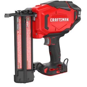

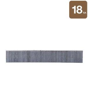

  1. Professional Method - Brad Nailer
  2. 1-in 18-Gauge Brad nails
  3. Brad Nailer
  4. Battery
  5. This method provides the strongest, most professional finish. While initially more expensive, it ensures your trim stays securely fastened for years to come.

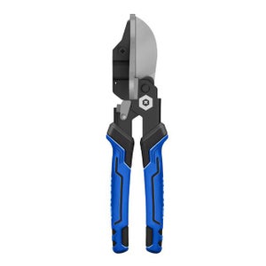

  1. Miter Snips (for precise 45-degree angle cuts)

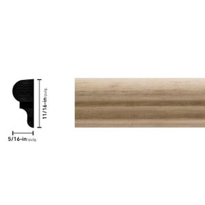

  2. Chair Rail Moulding*

*Note on Moulding Quantity: Calculate your total wall length and add 10% for mistakes. Each standard piece typically covers 8 feet. For reference, my project required 10 pieces, but your needs will vary based on room size.

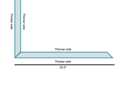

Step 5: Measure Your Picture Frame Molding
  1. Take your measurement from the outside edges of where your boxes will meet on the wall. Using a pencil, make a clear mark on your trim piece where the cut needs to be made. (Image #1)
Step 6: Cut Your Picture Frame Molding

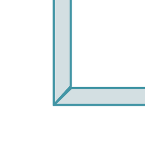

  1. Set your miter snips to a 45-degree angle (Image #1).
  2. We will always have a 45-degree angle so keep that in mind when cutting. (Image #2)
Step 7: Cut/Measure Your Picture Frame Molding (Cont.)
  1. Start with a single test piece of trim to verify your measurements before cutting all your material. This test piece will help you avoid costly mistakes and ensure your angles line up perfectly on the wall.
  2. When placing the trim in your miter snips, make sure the thicker edge (the part that protrudes the most) faces inward toward the fence. This positioning is crucial for achieving clean angles that will match up seamlessly. (Image #1)
  3. Place your marked trim against the miter saw fence, aligning your pencil mark exactly with the blade at the 0-degree point. Set your snips to 45 degrees, and make your cut. (Image #2)
  4. Tip: Always keep the trim firmly pressed against the guide or fence while cutting. Any wobble or gap between the trim and the fence will result in an imperfect angle. (Image #2)
  5. Remember: It's better to take extra time measuring and cutting than to waste material with rushed cuts.

Method A: Using a Brad Nailer
  1. Position Your Trim
  2. Place each piece exactly on your marked lines
  3. Use your level to confirm it's perfectly straight (Image #1)
  4. Hold firmly in place or use painter's tape to assist holing it up
  5. Double-check your 45-degree corners align properly
  6. Nail Placement
  7. Use 2-3 nails per trim piece (more for longer pieces)
  8. Space nails evenly along the length
  9. Always nail through the thicker, outer portion of the trim (Image #2)
  10. Avoid nailing too close to edges or corners to prevent splitting
  11. Proper Nailing Technique
  12. Position nailer flat against the trim
  13. Wait for the guide light to activate
  14. Apply firm, steady pressure
  15. Squeeze trigger smoothly
  16. Hold nailer in place briefly after firing

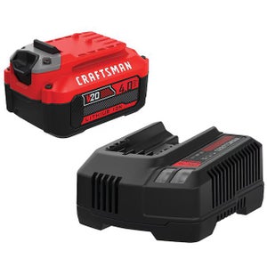

  2. If using a brad nailer, charge the battery before you start cutting. Nothing kills momentum like a dead battery halfway through.
