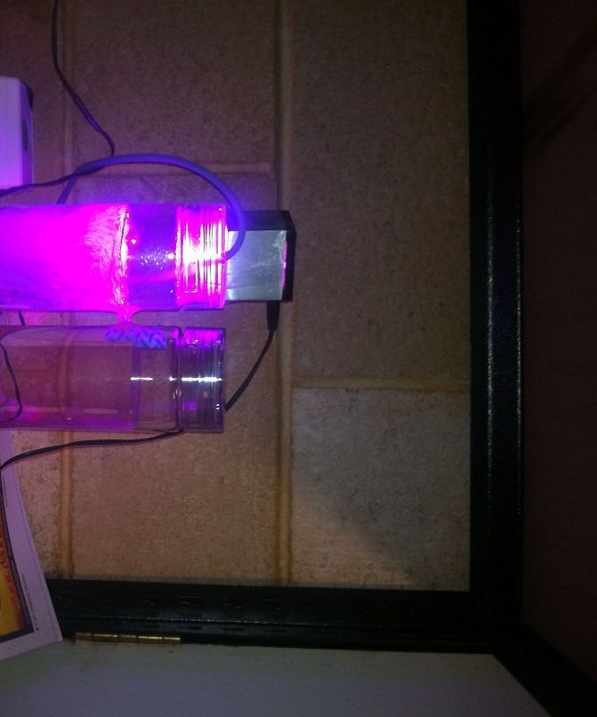

Step 7: Results.
Here is my first plant. It is a Western Australian trigger plant, Stylidium corymbosum.
The anthers of this plant are modified so that when an insect lands on a sensitive part of the flower, the anther wallops the insect and covers it in pollen. You can see it here, after a minute or so
My plant is sensitive to the bleaching step, and has been knocked a bit. But after 21 days, you can see a good callus in the second.
