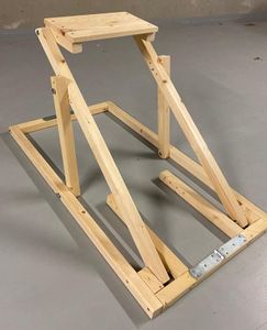

Step 1: Start With the Frame
Step 2: Add Support Beams
Step 3: Finish the Basic Frame
Step 4: Quickly Test the Playseat
Step 5: Create the Pedal Plate
If possible, fixate you pedals to the plate with some screws.
Step 6: Mount the Pedal Plate
Step 7: Add the Hinges (optional)
If you want to be able to store the playseat easily, add the hinges to the design.
Step 8: Finish Your Playseat
