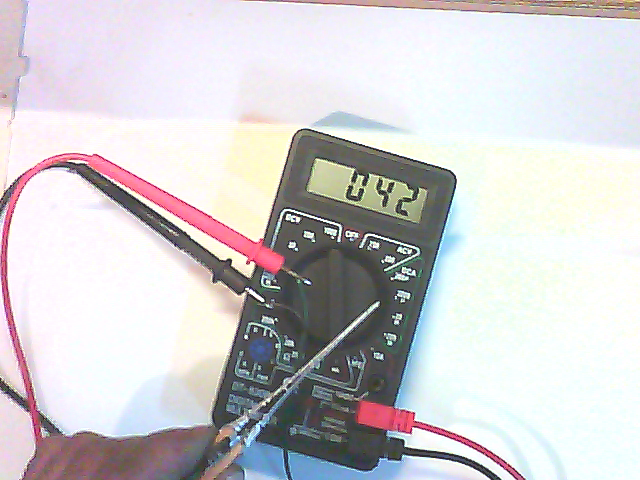

I usually assemble by hand all the boards I make. I use SMD components,
especially in 0805 format for resistors, capacitors and leds. With the last ones, I always have the same problem: I need to check the polarity of it, to ensure that I assemble on the right way. To do it, I need the multimeter, select the diode position and test the led's for the right polarity. Because on the assembly process I don't usually the multimeter, why don't make a tweezers to test the led's? It's an easy and very cheap project, and you'll have a usefull tool when assembly boards. Here's the result, after a couple of hours working on it ;). You can visit www.jechavarria.com for another projects!

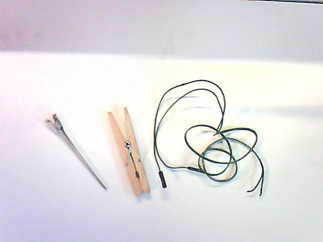

Well, the first is know the elements to use:
- Tweezers: I buy it on eBay. Total 2.06eur
- CR2032 battery holder: I use the reference 79548211 from Würth. Around 1eur or free if you request a sample.
- CR2032 battery: aprox. 1eur on local store.
- 220 ohm resistor.
- Heat Shrink Tubing (5cm).
- Soldering station (or just a solder pen).
- Hot glue.
So, for less than 5eur you can do it!
