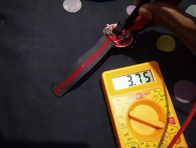

Step 7: About Battery Performance
I have been testing with this circuit on and off the breadboard and PCB for about a month now and the battery is in nice health

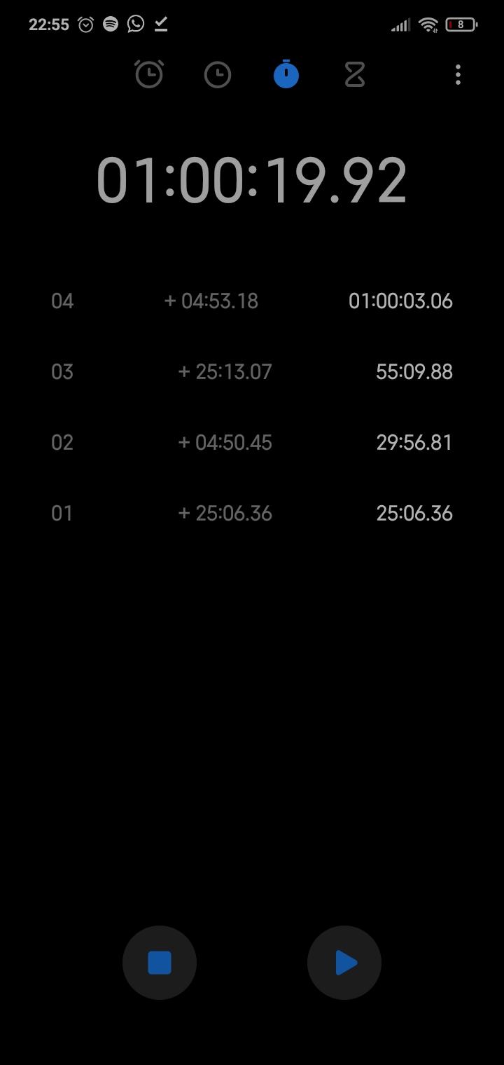

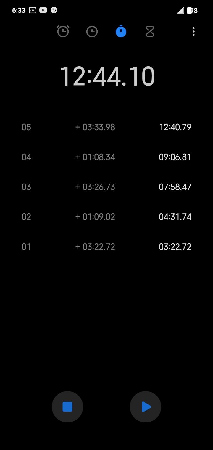

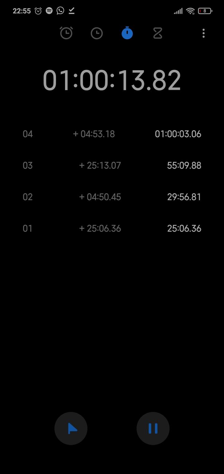

I have mentioned that the timing is not that accurate. This project relies on the ATTiny85's internal clock for timing which is not very accurate. Also, we have set the watchdog timer's timeout to be 4 seconds.
Here are some test results:
First I tried it for 3min and 1min break:
Then here you have the results for 25min and 5min break:

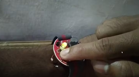

Step 10: Using Your Pomodoro PCB Watch
This watch works like a Pomodoro timer. It gives you a vibration when 25mins is over and another vibration, to let you know that your break is over. See the below GIF
If it is a watch it should tell you the time right? Yes, it does, but only informs about how much time is remaining in your 25min (or I would say, in your focus time).
If you want to know approximately how much time is remaining, you can press the pushbutton and the LED will show you Green, Orange, or Red. If it is between 0 and the first 15min it will show you, Green,
if it is between 15 and 20mins you will get Orange,
similarly if you have only 5 more minutes left, then the LED will be Red.
It is not the best in my phone's camera, but believe me, there is a significant difference between the orange and red. (You can see the color better on my thumb due to the reflection)

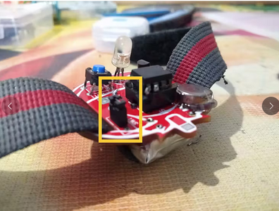

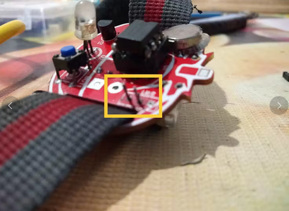

I couldn't get a slide switch of that same footprint as in the PCB so I soldered two conductive legs and added a jumper between them to act like a switch.
And also made the mistake of not measuring the footprint of the pushbutton. So I had to make some adjustments and finally, the pushbutton compromised to solder it to the PCB.

I tested this watch several times and it has an inaccuracy of 2 minutes for 25 minutes, because of using the watchdog timer. But don't worry I have rectified it in the code.
