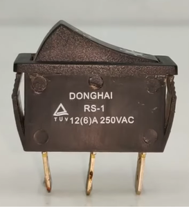

Add On/Off Switch:
  1. Hot glue a toggle switch to the converter
  2. Wire it so turning it on/off controls the power
  3. This lets you save battery when not using it

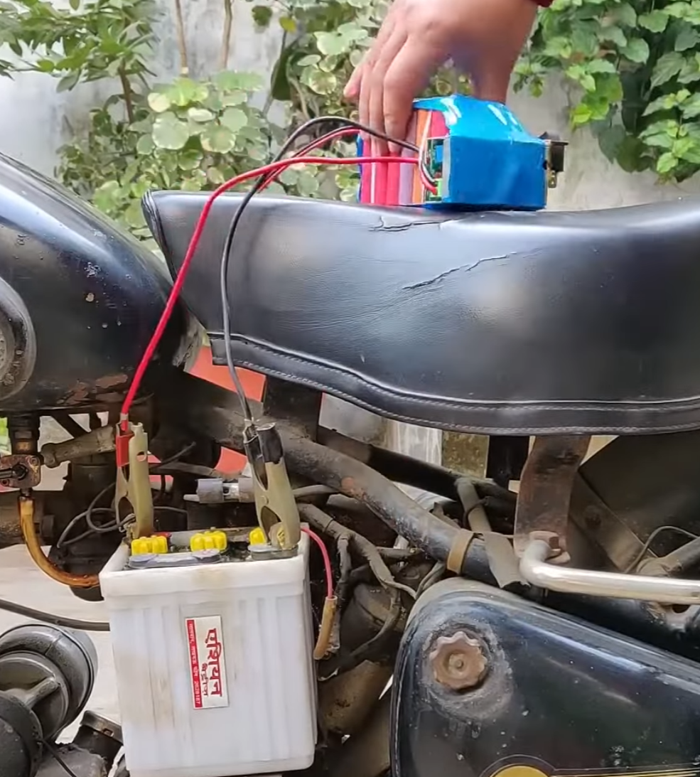

Charging Old Motorcycle Batteries (6V)
Before charging:
  1. Open battery case
  2. Check water level inside (should cover the plates)
  3. Add distilled water if needed (not tap water!)
  4. Clean any green corrosion from terminals with a wire brush
Charging:
  1. Set output to 7V (one turn counter-clockwise from 14V setting)
  2. Connect clips - red to +, black to -
  3. Charge for 2-4 hours
  4. Should go from 2-3V to 6V

Simple Performance Info
Battery Pack Specs:
  1. Voltage: 11.1V normally (12.6V when full)
  2. Can discharge: 3-6A safely
  3. Capacity: 6000-9000mAh (how long it lasts)
How Long It Runs:
  1. At 1A (slow): 6-9 hours
  2. At 2A (faster): 3-4.5 hours
  3. Charging a dead 35Ah car battery: 4-6 hours
Converter Efficiency: 85-92% (some energy becomes heat, which is normal)
