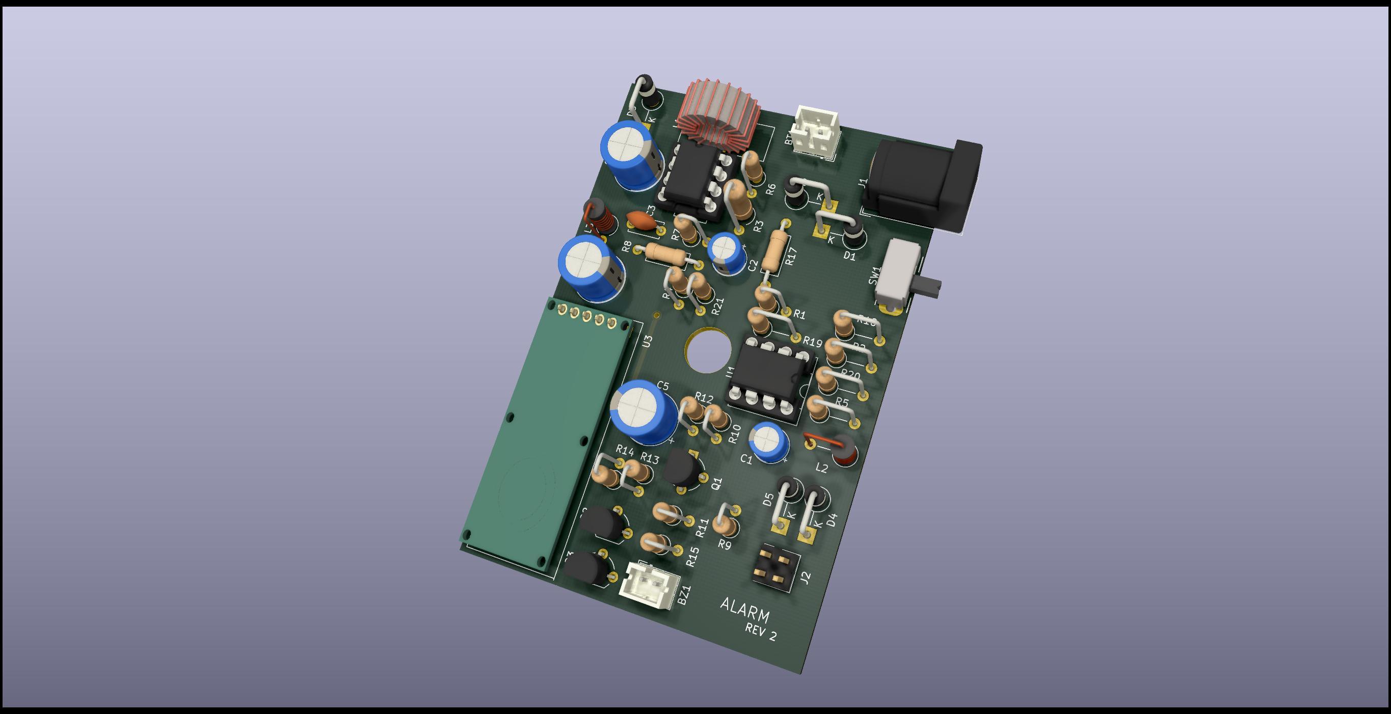

Here’s a project I did over the weekend - an alarm system that gets triggered whenever the power is cut, or when presence is detected within a 7-meter radius of where it’s placed. It is a 100% Analog project that’s easy and cheap to make, even by people who don't understand what's going on in the circuit.

In this particular circuit, I am using a 28V active buzzer that draws 15mA when conducting. Efficiency can be greatly improved by using low-ESR capacitors, choosing a better inductor, and most importantly lowering the boosted voltage. If you can find a sufficiently loud active Buzzer rated at lower voltage ex. 12V, you only need to change the feedback resistors and your efficiency should drastically improve - but is it worth the additional effort? That depends on how often you expect the device to trigger while the electricity is cut. If you live in a country that has a stable electrical grid, or you don't mind spending cca. 2$ on a 9V battery now and again, you probably shouldn't bother.
N/C Parts
You may have noticed some N/C components in the circuit. They have been placed just in case something needed to be tweaked after the board has been made.
  • R16 - If omitted, Power Trigger will be delayed for a few seconds after the electricity is cut - duration depends on the type of a Wall Wart you are using and it's output capacitance. The lower the value, the faster the triggering is.
  • R15 - Some Buzzers may may require a resistor placed in parallel to work.
  • R14 - Optional pull-down resistor to prevent the D-Pair from conducting when it shouldn't.
