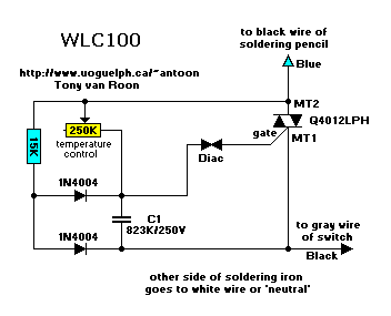

Step 1: Electronic Diagram
The circuit diagram its based on the Weller WLC100 electronic soldering station, and was reproduced by Tony Van Roon, so you'll sure that this has been test it so many times before...
Step 2: Parts and Tools
You will need:
2 - Diodes 1N4004 (can be from 4004 to 4007, and thus every replacement that exist)
1 - 250k Potentiometer, with its knob
1 - Diac, bilateral trigger type
1 - Triac 400v/25A ( i used the BTA08 at 600v)
1 - Capacitor 823k 250v (83nf, i used a 100nf)
1 - Resistor 15k, 1/8 watt or more

Step 4: Soldering
Not so difficult right? well, it depends on your pulse, experience and confidence, but there just seven components, so i know you will achieve it.
If you want you cant test it before in a protoboard (the center and the left pins in the potentiometer in the second photo are those you're looking for...)

Step 6: My Measures
So this is what old friend WLC measures vs the little new town guy...
The crazy thing its that our circuit got a more proportional change in the voltage, so im not sure what to think, maybe there's life in other planets...
But it works, now you got +1 in DIYlogy...
