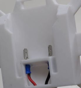

Now it's time to assemble the adapter for the Parkside tool battery. The corresponding 3D printed adapter has a small "pocket" with 2 slots for sliding in a 6.3mm spade connector in each one. These spade connectors, first need to be crimped or soldered to a wire, and then inserted with a bit of force inside these slots to become the battery terminals. Optionally, you can cover this hollow area (where the spade connectors sit) with hot-glue to make them one with the plastic part. Finally, you can screw the adapter on the top-right corner of the pedal board.
