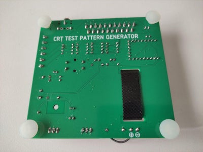

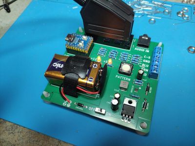

This project emulates the functions of a once-common tool in CRT repair labs. It produce a series of low resolution images (test patterns) useful to check and fine tune CRT raster's geometry, colors, contrast, convergence etc. etc.
It is built around an RP2040 microcontroller board and a few other components.
Some features of the CRT Test Pattern Generator object of this instructable are:
- compatibility with low resolution arcade monitors (320x240 @15KHz)
- compatibility with EUR- SCART TVs
- small footprint
- portability (battery operated)
- cheap! (is this a feature? For me it is :))
No special components have been used.
As a general rule, I stick with through hole components. They are easier to deal with, especially because they don't ask for special soldering equipment. This project made no ecception and I tryed to use THT only, but in the end it was not possible.
Having SMD components (only two!) makes the project a little bit more difficult to assemble, but anyway doable even if your soldering skills are not top-notch.

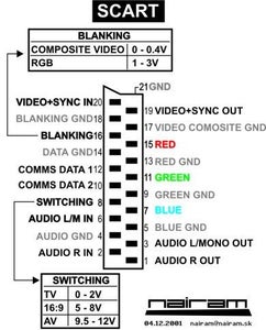

This connector was common in CRT monitors for PC, but unfortunately not in european CRT TVs, nor in arcade monitors.
SCART is the common choice in RGB TVs (at least here in Europe), which is a strange beast with commutation signals needed to adeguately trigger it's operation modes without a remote control.
SCART is not "active" meaning that it's not internally amplified, but calls for mandatory, static voltages at some of it's pins for normal operation.

EUR-SCART monitor are free from the aforementioned impedance and RGB level challenges, being them actually home TV's with the exact same logic of those PicoVGA was developed around.
The SCART standard has anyway specific rules that must be followed in order for a signal to be accepted by the receiving monitor.
One is the so called "blanking" signal (pin 16). This has to be in the 1 - 3V range to tell the monitor "hey, you are now receiving an RGB signal!".
Automatic switching to AV channel is also important because it frees from the use of the remote control. Automatic switching to the AV channel is possible by applying a tension of 9.5 to 10V on SCART pin 8.

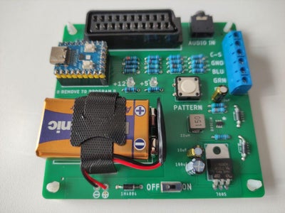

The battery of choice for this project is a 9V alkaline battery. I opted for it mainly because of it's dimensions and availability.
A common way to juice the RP2040 Zero is by applying 5V regulated at the power pin. The microcontroller board is not power hungry, nor we have to drive big loads here, so a simple circuit built around a classic 5V voltage regulator is more than enought.
Tensions we have available in a powered pi pico are 3.3V, 5V and the plain B+. What is still missing is the +12V line. To generate such voltage I placed a dedicated, built-in step-up converter circuit.
*In my experience they work well with even lower voltages (1-2Vpp), but something stronger than 0.7V is definitely in the need.
Step 4: Circuits
In the following the description of the main circuit blocks.
Main Voltage Source (+5V)
The RP2040 microcontroller board here used (RP2040 Zero) asks for +5V for normal operation, then regulated to 3.3V internally. We need to step down the B+ (9V, unregulated) to +5V (regulated).
A simple way to do this is by using a LM7805 voltage regulator. This is not the most efficient way to do it (better than a voltage divider though!), but works well when only small currents are requested.
The amount of current drawn by the whole circuit in operation is so small, the regulator stay warm, if you are asking :)

In EUR-SCART, automatic AV switching is activated by applying a tension in the 9.5V to 12V range. This makes it possible to avoid the use of a remote control to switch to AV channel, which is very handy.
To generate +12V from our +9V supply I have adopted a very common circuit for DC-DC boost voltage converter. It is based on a MT3608 step-up converter and, if you are an Arduino fellow, most likely have some module based on this same circuit at home :)

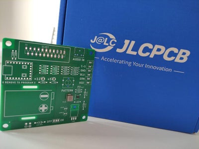

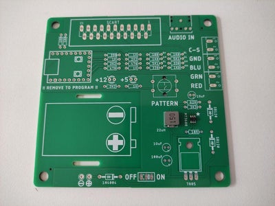

Step 5: SMD Components? No Problem!
You are very likely aware, at this point, that this project uses two SMD components*: a 22uH inductor and the DC-DC step-up converter (MT3608). These are big enought to be soldered by hand, but in case you are still not confident you can take advantage from the assembly service most PCB manufacurers offer.
In this project I had them assembled by JLCPCB, and I can confirm everything work as it should!
When I ordered my prototipes 22uH inductors in 0650 footprint where not available. I used 15uH and can confirm everything work as it should. Looking at the DC-DC step-up converter datasheet I can see that even 4.7uH inductors could be used, so I must suppose even such a low value will work.
Here are the specifications of the two SMD components of this project. Use them to research in the manufacturer library:
- Inductor, 4.7uH or 22uH (or any value in between), 0650 footprint
- DC-DC step up converter, MT3608, SOT-23-6 footprint
If the specific components I used at the time of this writing are not available, use an equivalent. The important is the kind of device if it's an IC (oh well...), the rated value if it's a passive component (i.e. resistor, capacitor, inductor, etc.) and it's footprint, in order to match the PCB.
All files necessary for SMD assembly and Gerbers for PCB manufacturing can be downloaded at the Github link in the "Aknowledgments" Step of this instructable.
*Please notice that these two SMD components are used in the +12V generation circuit. Being this only used at SCART level, you can omit them if you are targetting the Arcade application only.

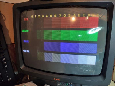

- Cycle between patterns by pressing the tester on-board button.
These patterns are in 320x240 resolution, and will help you finely tune the geometry, colour and contrast of your arcade monitor or TV.
At the time of this writing, the device can only output negative sync signal.

Prototype Issue
My first prototype had a flaw with SCART pinout that prevented it from working (note to self: never trust others footprints!!). I have now spotted and fixed the error. Anyway, I have not a copy of the fixed PCB in my hands so the shared design has to be considered UNTESTED. I will have the PCB manufactured in the near future and will test adeguately the fixed design.
EDIT: PCB is now tested and confirmed perfectly working!!
