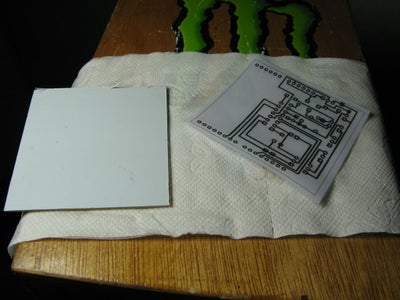

Here's a preview of my DIY UV exposure box that I made this past December. I use it for developing "Presensitized PCBs" (Photopositive PCB). Presensitized PCBs are usually developed under sunlight, it takes 3 minutes to fully expose it. By the aid of my DIY UV box, it speeds up the process to 30 seconds! It's also reliable compared to the sunlight method and fluorescent method.

First of all this gadget only works with Photo-positive PCBs, NOT FOR TONER TRANSFER METHOD !!! I've done the process with my "DIY Arduino Motor Shield", from my previous ible guide. Since summer (school break) just started, I'm planning to post more ibles about Arduino projects with PCBs, I'l show you how I develop my presensitized PCBs on my next ible guide.
Why Use Presensitized PCBs instead of Toner Transferred PCBs?
Based on my experience presensitized PCB making is one of the most reliable and efficient way of fabricating precision made PCBs. As we all know from our experience in making Toner Ink Transfer PCBs, there's a lot of broken lines and blotted ink, this is bad since some lines could short the project after etching. The advantage of presensitized PCBs, is the reduction of broken lines. It's so precise, you could make PCBs with lines as thin as a strand of hair!
