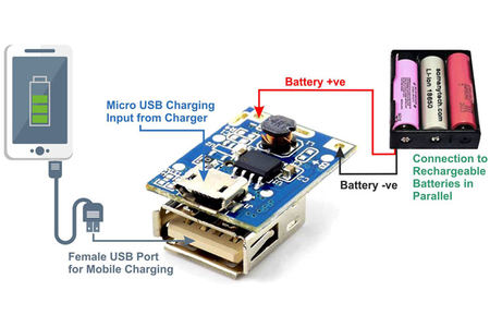

Step 3: Circuit Diagram
The circuit is simple. Connect the +ve terminal of the battery to the +ve terminal of the module, and the -ve terminal of the battery to the -ve terminal of the module. Refer to the circuit diagram for visual guidance.
You can also use the type-C 5V USB Step-Up Power power bank charging Module with charging protection (134N3P) module instead of the common type-B module (I have this type-B module sitting around my home, which I have used in this project).

Step 5: Testing the Circuit
  1. Check Output voltage: Set your multimeter to the DC voltage measurement range and connect the test leads to the output pins of the USB port (refer to the circuit diagram for pin locations). The reading should be close to 5V. If it shows no voltage or less than 5V, proceed to troubleshooting (point 2).
  2. Troubleshooting: Inspect the soldered joints and wires to ensure there are no loose connections or shorts. If the battery or module is heating up more than expected, it may indicate a short circuit inside.
  3. Test Device: Connect a small electronic device to the USB output to confirm that it charges the device properly.
