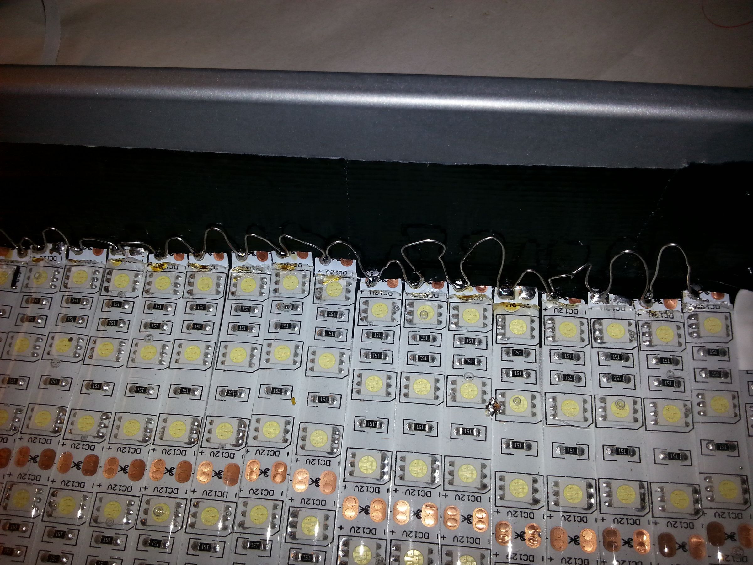

While gluing everything down the I alternated having the positive and negative poles upwards towards the top of the base. This makes it easy to connect half of the positive and negative leads with blobs of solder, which in turn means you only have to use half as many wires when you solder everything later on. Saves you a lot of wire stripping!
Step 4: Soldering
Okay, time to solder!
You need to connect all of the strips so they all share a common ground and a common positive voltage connection. When soldering all the tiny, cut LED strips and segments you want to connect the positive pole of one segment to the positive pole of another segment. The same applies for the negative poles on all the segments.
I started by connecting the ground leads. This can be done anywhere on the led strips and not only on the edges of the strips. I connected all the ground leads that were next to each other by laying down huge blobs of solder. And then I did the excat same thing for the positive leads.
After this I connected every other positive lead together, and every other ground lead to each other using short hookup wire.

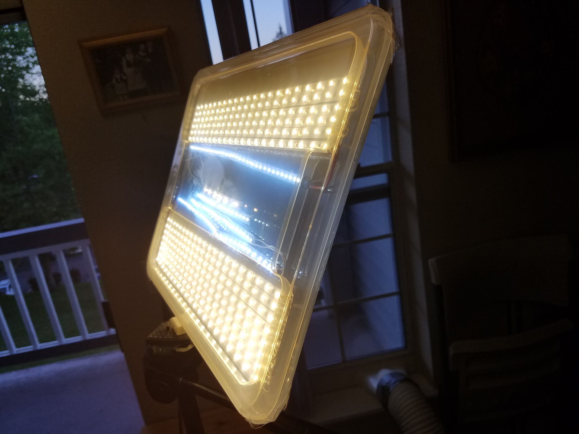

And we're done soldering! This means the project is basically done. We just need a nice way to mount the panel and spread that nice light all around.
Step 5: 3D Printing an Adapter
To mount this panel on a tripod I designed and 3D-printed a real simple and really strong grip for the panel. This simply slides onto the panel and grips it firmly. Then all you have to do is screw the panel with the adapter onto whatever you have with a tripod screw, which is 1/4 inch.
This was printed with functional threads so you don't have to prepare the adapter in any way. Just remove from the printer and mount right on top a printer! To get the functional threads I printed this with a resolution of 0.1 mm and 5% infil. You can download the STL file here.
You're done! Connect the power source and the dimmer, and everything should right light up!

7 years ago
did you really have to solder the ground leads together in the middle of the strip? I was under the impression these strips are electrically connected if you don't cut them. Seems like you had an unnecessary extra step there.
Reply 7 years ago
That's correct the whole 5 m roll is connected and can be powered as such. The reason I cut the strip into smaller segments was for gluing them onto the panel base.
It would be possible to continuously glue the whole LED strip to the base without doing any cutting and soldering. However, this would bundle up the LED strip around the sharp and bent corners. Which in my opinion wouldn't give a clean and professional look.
Reply 7 years ago
I thought the same as the above comment.... surely you'd only need to solder a connection from the end of the first strip, to the start of the second, then end of the second strip to start of the third... and so on.
I too am missing the point of the connections you made mid strip

7 years ago
So, approximately 400 lumens. That sounds just about right for a workbench or desk. I think I've got just the place for it. Thanks for your effort and info.
