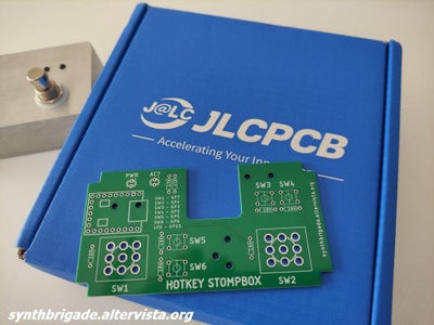

  3. I will also share Gerber files to have the PCB manufactured.

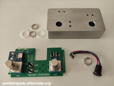

The PCB I layed down is dimensioned for compatibility with the following components:
  1. 1x aluminum alloy case (1590B, 112 x 60 x 31 mm)
  2. 1x panel mount USB type C TPC connector, 4 wires (those used to add a USB charge slot in cars)
  3. 1X USB type C male connector (those with exposed terminals through a PCB)
The stompbox PCB is populated by the following components:
  1. 1x RP2040 Zero microcontroller board
  2. 2x PCB mount footswitch 3PDT 9 pin (latching or non latching)
  3. 4x PCB mount micro switch 6x6 mm, 20 mm height (tall aren't they? :D)
  4. 2x 680 ohm resistor
  5. 6x 10K ohm resistor
  6. 2x LED, 3mm

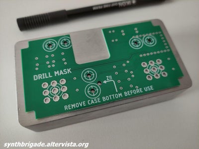

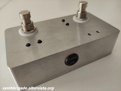

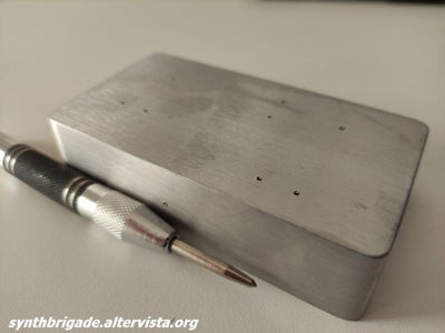

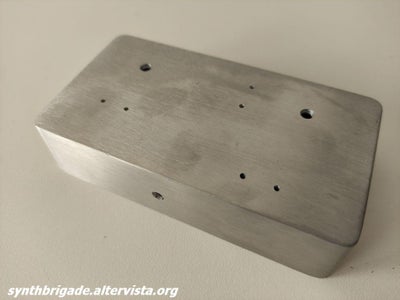

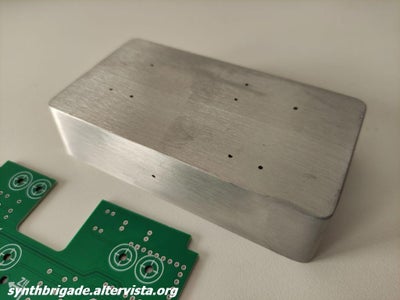

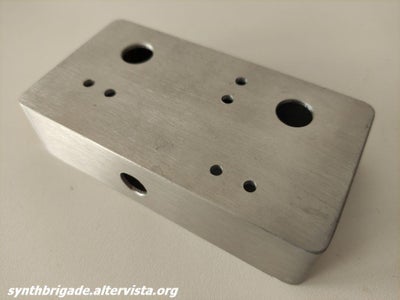

Case Drilling
This phase consists of two operations: face plate drilling and power connector hole drilling.
Face plate drilling is the realization of holes to host the two foot switches, the four tactile swithes and LEDs.

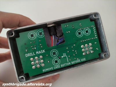

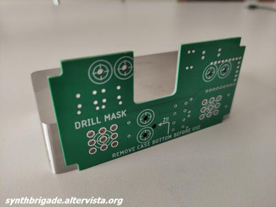

The bottom side of the PCB has a drill mask to simplify the work and help centering them "perfectly".
The holes with a white circle around are dedicated to the faceplate. The hole (single hole) named "Z!!" is the one to be used to drill the USB connector's hole.
Please notice that you have to remove the case's bottom before marking the height (Z!!) drill point.
As a general rule, keep driller speed low when drilling metals.

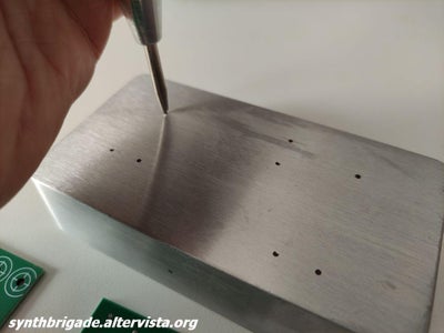

Operations
1) center the drill mask over the face plate, then on the correct case's side.
2) mark hole positions with a pen.
3) use a hole puncher to notch all positions.
4) drill a first centering hole in all position with the smallest drillbit possible.
5) enlarge holes up to the desired dimension.
Notice that the PCB is slightly asimmetrical and the power connector is shifted 0.20" (5 mm) apart from the exact center position of the case. Use the PCB dedicated hole (named "Z!!") to mark the exact Z hole center position.
Center the drill mask (bottom side facing you) onto the case external surface and lock it firmly with some adhesive tape.
The shared PCB drill mask also has the final dimensions of the holes silk-screened.
Keep all elements around so that you can check at every step if the hole you are drilling is big enough to host it.

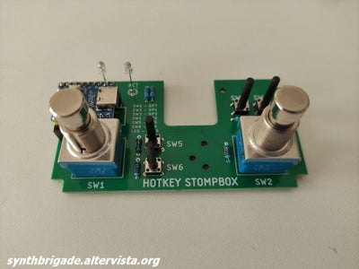

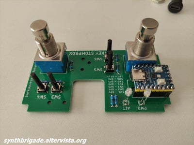

PCB Assembly
Now that the case is ready (pfew!!) we can proceed with PCB population!
  1. Populate smaller components first (resistors), then the female headers to host the microcontroller board. Resistors values are silk-screened, so a value map is not necessary.
  2. Place in position tactile switches and solder one leg each (only one!) then. Be 100% sue they are correctly aligned!
Do not solder footswitches and LEDs for now.

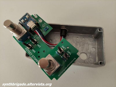

Now, align components inside the case.
  1. Looseny screw foot switches in place (they must be able to move in this phase).
  2. (leave the LEDs out for now!!).
  3. Insert the PCB inside the case.
  4. If everything fits well, solder all switches legs to the PCB.
LEDs deserve special care. You want them to fit into the hole without popping out too far or creating residual stresses on the pads.
To acomplish this:
  1. Insert LEDs with the right orientation though the PCB. Keep them loose.
  2. Place the PCB inside the case and firmly screw the foot switched.
  3. Position LEDs such that they enter case hosting holes.
  4. Solder LEDs in place.

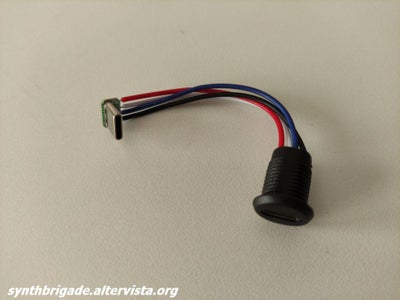

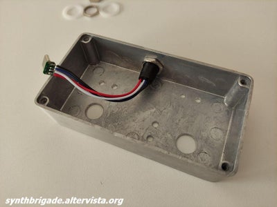

Power Connector Wiring
The panel mount USB connector here adopted has free cables to be soldered to a type-C male. The male will then be inserted into the microcontroller board.
The male type-C connector I have adopted has a small PCB exposing relevant (USB 2.0) terminals.
The cable color code for the panel mount USB connector is:
  1. V+ = Red
  2. D- = White
  3. D+ = Blue
  4. GND = Black
Carefully solder ground, voltage and data lines to the appropriate pads on the male type-C connector, and you will be good.

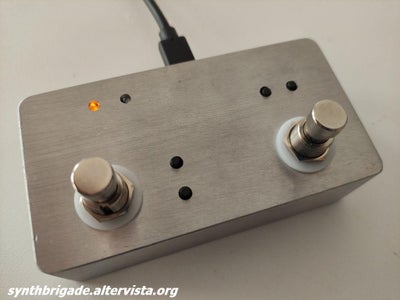

Step 4: Testing
Visual Test
The stompbox is equipped with two LEDs giving a visual feedback about the health state of the device.
The power LED is connected to the 3.3V line (internally generated by the microcontroller board), so it gives feedback about the microcontroller being feeded adeguately. Issues here would call for a problem in the USB line (likely) or defective on-board DC-DC step down power converter (unlikely).
The second LED gives visual feedback about the microcontroller activity. It blinks briefly on startup to tell "hey, I am listening and ready to rock!" then turns off.
Functional Test
The simplest and effective functional test can be performed by opening note pad (or any other PC program where you can write) and press stompbox switches. This is a foot keyboard, remember? It can be used to send keystrokes to any software.
If the functional test works and you are experiencing some issue with your target software (i.e. your DAW), check its hotkeys assignation map.
Don't test the device directly on your target software because if something goes wrong, you will not be able to discern if it's a stompbox issue or software issue.
