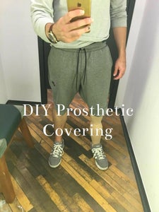

Introduction: DIY Prosthetic Leg Foam Cover (Cosmesis)
A prosthetic covering, known as a cosmesis, is designed to make the prosthetic device more human-like. Unfortunately they can only be ordered by a licensed prosthetist and typically range from hundreds to thousands of dollars. Since it's summer and time for some shorts weather, a friend of mine contacted me about making one before he left on a trip to Europe. This instructable offers steps to design your own foam cover for a prosthetic device for a cost of $45 with a time to build of about 3 hours. Since there are many different kinds of prosthetic devices these are sample steps with ideas on how to customize this process for your specific device. The original unaltered device can be seen in the images here with the final, covered product shown in the title image. You can also check out a quick video taken when testing that the covering didn't interfere with the operation of the device.
