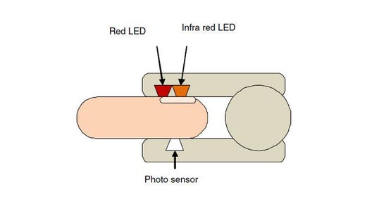

How An Oximeter works?
Basically Oximeter calculates the percentage oxygen saturation in the blood on basis of amount of different light absorb in it. Oximeter has One photodiode and two LEDs one is Red LED & another one is InfraRed LED, both LEDs are switched one by one on a certain frequency. To take measurements fingertip is placed in between of photodiode and LEDs as shown in the picture. Oxygenated blood absorbs more Infrared Light and passthrough the more red light and Deoxygenated blood absorb more red light and passthrough the more InfraRed Light. Processor calculates the ratio of red light received at photodiode and Infrared light at the different time interval. for more details on Pulse Oximetry Basic Principles and Interpretation visit this or see this pdf on Pulse Oximeter Fundamentals and Design from NXP
