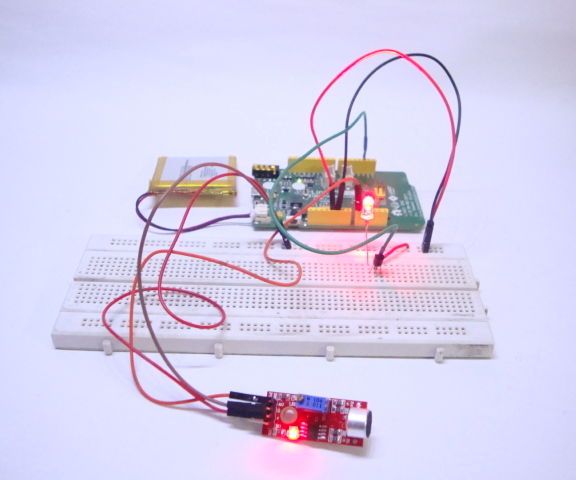

Step 2: Start Making
- First step is to take jump cables and connect some long peices of wires on all the three cables.
- Secondly, connect the vcc pin of sensor to 5v of linkit one using these wires.
- Then connect gnd pin of sensor to gnd of linkit one.
- Connect the output pin of sensor to pin A0 of linkit one.
- Lastly add some tape at the loose ends of the sensor as well as the linkit one.

Step 4: Upload Code
Upload the code which I have included below by selecting correct COM port and Board in your IDE. The switches on the board should also be in the correct position.

Step 5: Open Serial Monitor and Test It
As you upload the code, open the serial monitor. Now you will see your pulse rate values displayed on the monitor. Please remember that the sensor should be touched on your finger.
