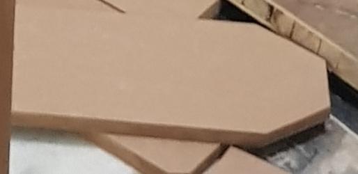

Step 3: Building the Front Panels
I was looking for some interesting panel design for the front, then narrowed down on this half-hex design which makes the front look more sporty.
I cut these panels of the size: 32 x 14cm and then made 4" holes for the drivers.
Using a wood router and a 45 degree bit, I trimmed down the edges and also made a straight cut using a V-shaped bit.
